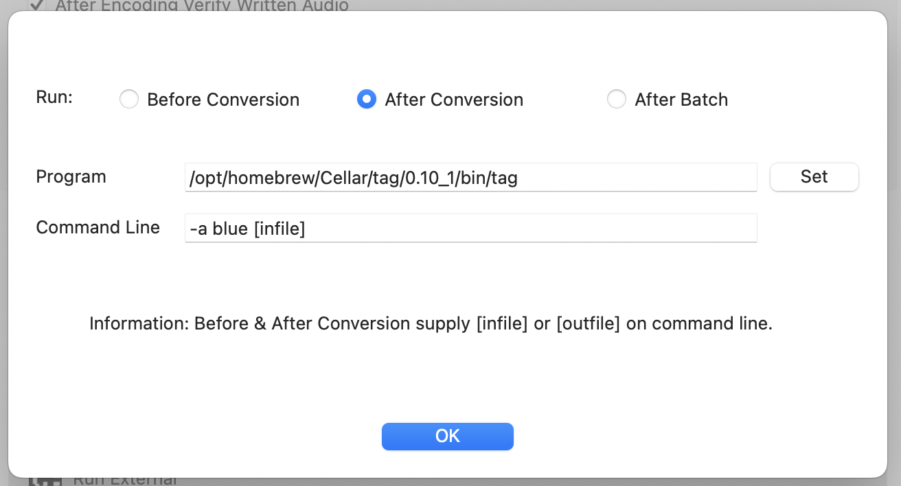

    On Mac OS, I want to tag (label) files after conversion, so I can move them manually.
    I think the easiest way to do this is to use the utility 'tag' (installed by homebrew, brew.sh) so I can simply go:
    Code:
       tag -a blue [infile]
    • I can do the above command in Terminal (tag -a blue example.flac) and it works fine.
    I thought I should just add the DSP "Run External" and provide either the the full command above, in the "command line" field, or maybe provide the program path in the first box, and the parameters in the second box.
    Neither works.
    If the below is wrong — what's the right way?
    Screenshot
    Tag is installed by homebrew in /opt/homebrew/bin/tag (a link to /opt/homebrew/Cellar/tag/0.10_1/bin/tag).

    You would need "[outfile]" and in quotes
