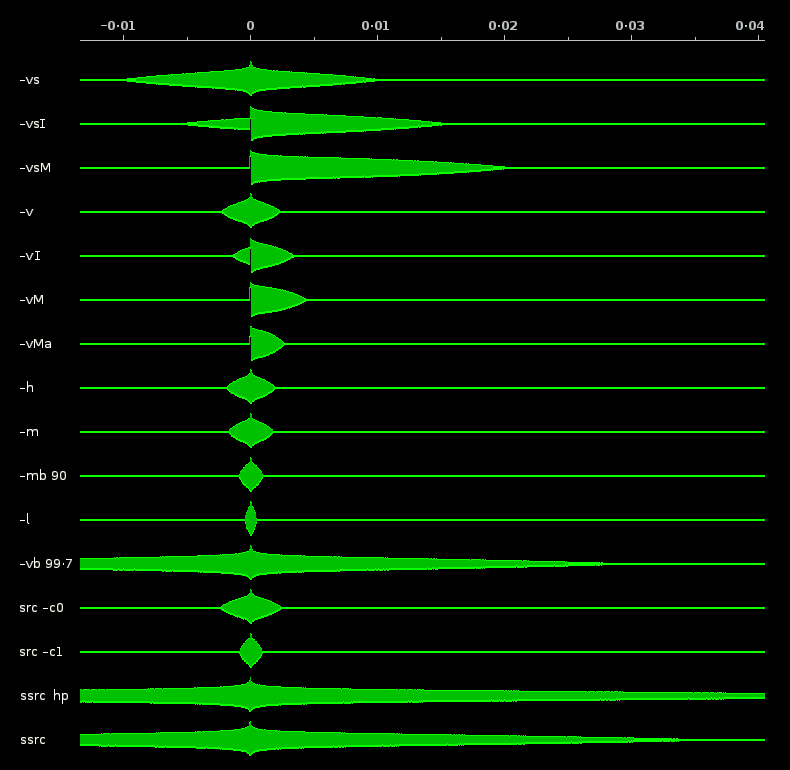

    SOX is more flexible than SSRC. For example it allows to select the phase behaviour during the conversion, which SSRC does not. Our listening panel can definitely hear the difference between different phase behaviours and it is not always the same setting which is optimal to our ears. The difference is also visible in the time domain. This picture shows the result using different settings of SOX and has SSRC HP and SSRC at the bottom.

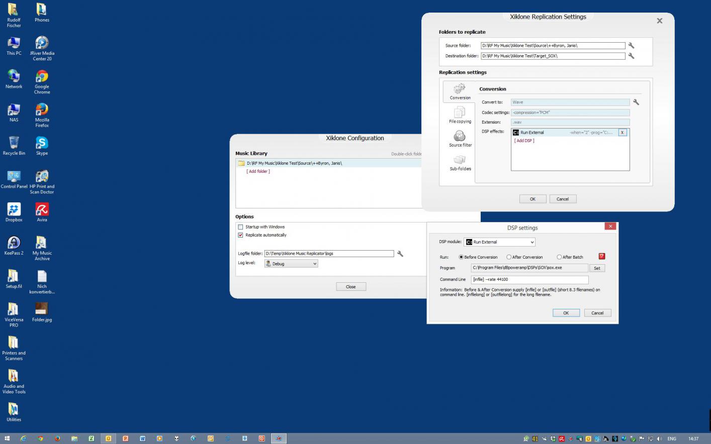

      I am trying to invoke it from Xiklone. The conversion task runs, but the file remains at 176.4kHz.
      I have attached the screenshot from the Xiklone command line. I am using
      [infile] --rate 44100

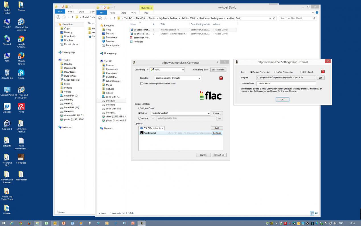

          I have done the following:
          - Eliminated Xiklone as a source of error and gone to a plain conversion FLAC -> FLAC with Music Converter
          - tried all possible combinations of - (StdIn), infile, outfile
          - "[outfile]" --rate 44100
          "[infile]" "[outfile]" --rate 44100
          "[infile]" --rate 44100
          But the file comes out in 176400 every time
Name:	SOX Conversion Command Line.jpg

            You have to first get working direct away from dBpoweramp, create a wave file then try to run sox from the command line to get it to reduce the frequency of the wave file.
