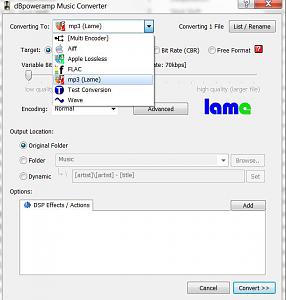

    Hi
    I installed the latest release (15)
    I had to reinstall Arange Audio codec from the dbpoweramp (latest release)
    But what's happening is when I select the files and go to the drop downdown list Arrange Audio isn't listed?
    I rebooted my computer etc.
    Any suggestions?
    (see attached)
    • 46220
    Re: Arrange Audio Arrange audio tracks based on ID Tags (Requires Reference)
    You must have 32 bit and 64 bit installed, see:
    http://forum.dbpoweramp.com/showthre...-Compatibility
    You have to delete the 32 bit folder, otherwise the 32 bit codecs install.
