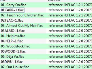

                    Thanks... slight problem
                    If I use -o "[outfile]" "[infile]" I can see its converting and temp wav and flac file are written within the same folder, however by the time the process ends I have the same flac 1.2.1 which I started with not flac 1.2.0 and both the temp wav and flac files have disappeared. It appears that the new flac isn't overwriting the old.
                    If I remove the "-o" it does encode to 1.2.0 but a new short filename is created with isn't tagged.
                    In other words I end up with the old 1.2.1 and a new short filename (untagged) 1.2.0 See screenshot attached.
                    Is there a way to overwrite the existing flac and retain file tagging?
                      Re: Help please old flac 1.2.0
                      The version indicated is because the ID Tagger updates the version, but the file is still encoded as a 1.2.0 file. Try using the DSP effect ID Tag Processing, set to remove all ID Tags, the file should be a 1.2.0, see if it plays.

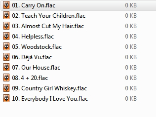

                        I appreciate your doing your best to help me but still having problems.
                        I've also removed the tags prior to conversion but still no joy I'm afraid.
                        Using -o "[outfile]" "[infile]" with DSP remove all tags the file is complete but doesn't play. I thinks it's still flac 1.2.1 which hasn't been overwritten within same folder.
                        When I choose the option to save file to different folder using -o "[outfile]" "[infile]" dsp tags removed the resulting file is 0 size. see screenshot
