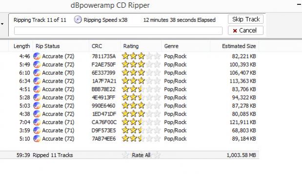

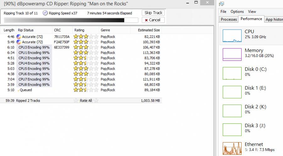

    Hi there...
    Encoding Issue, taking forever...
    This is my first rip with R15...
    As you will see in the first image - the first two encoded very quickly, the next 8 sat there for a long time, and in the second image it finally did complete.
    Not sure what I was expecting but I don't think the intention was for a single album rip to take 13 minutes with 8 cores being held but not seemingly doing anything...
    It is also noted that size of course matters...but on this album the tracks they are all relatively the same size.
    Nothing else is running on the system...
    I've done the same album again with hand written results as follows:
    Start rip @ t=00:00
    t01 complete t=00:40
    t02 complete t=01:08
    8 cores now in use - CPU = 0% from task manager
    tracks 3-10 are sitting at "CPU Encoding at 99%"
    This is where the problem starts - 8 full minutes before the next encode finishes...
    t03 complete t=10:05
    t04 complete t=13:05
    t05 complete t=13:06
    t06 complete t=13:15
    t07 complete t=13:07
    t08 complete t=13:05
    t09 complete t=13:06
    t10 complete t=12:50
    t11 complete t=13:06
    My system:
    Intel 8 core
    16GB RAM
    SSD hard drives
    NAS storage
    Win 8.1 x64
    Happy to help/debug to resolve this issue...
    Another question, is is possible to turn off MultiCPU encoding to test this? I can't find this option anywhere...
    Thanks and regards
    Seán
    Re: Encoding Issue - taking forever on a 8CPU
    >NAS storage
    This will be the issue, set the output folder as a local drive and it will not have issues.
