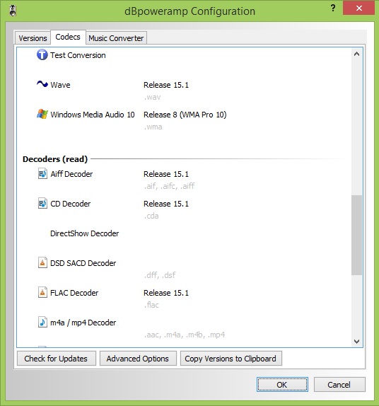

    Now, after installing the directshow plugin, this is what my codecs tab in config dbpoweramp shows:
    you can see that DirectShow has no file linked to it.

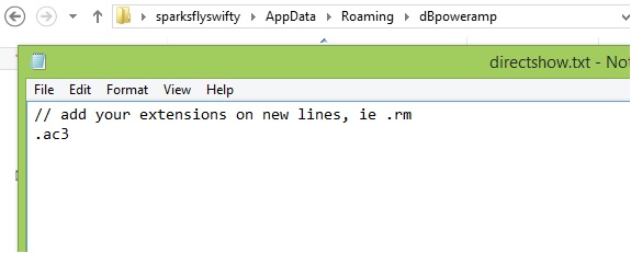

    This is the directshow.txt entries:

        No.
        I installed the directshow plugin. I then installed ac3file (as per the instructions, using the link).
        config dbpoweramp shows as per my screenshot in my previous post - no associated file type with the directshow plugin. music convertor does not see .ac3 files.
        I then manually edited the %AppData%/dbpoweramp/directshow.txt file and added .ac3 as a file type on the next line as per the instructions. Music Convertor now sees .ac3 files.

        edit: well, well, well - I re-ran config dbpoweramp after editing directshow.txt and now it shows the .ac3 file type associated with directshow and I can see the convert to option when right clicking on a .ac3 file. It NEVER did this before...
