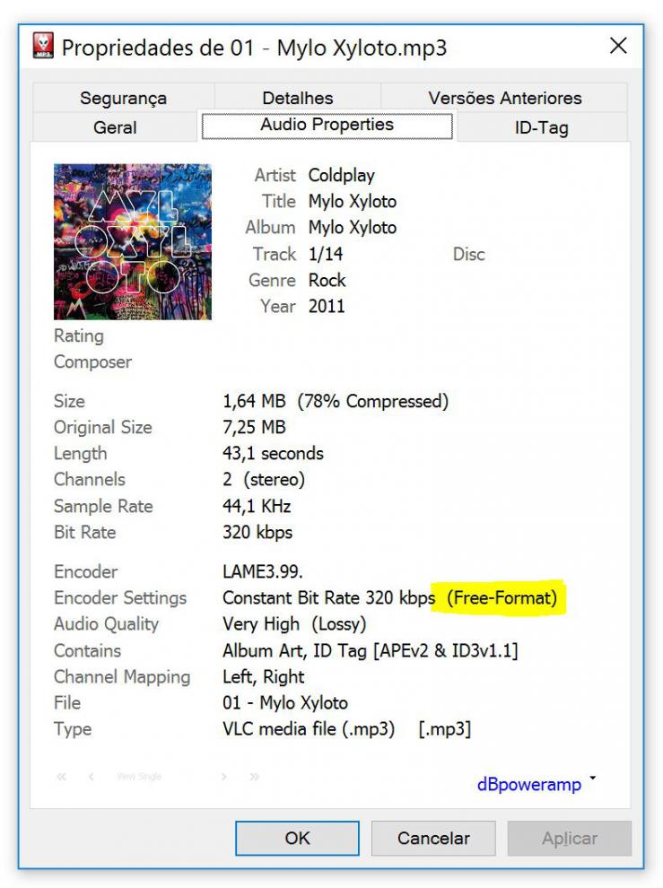

                Hi everyone.
                I have the same problem, the MP3 generated with 320 Kbps settings are UNPLAYABLE
                in my card audio MP3 (Original Honda Civic 2013 audio wiht USB input) and,
                IMHO, this IS A BUG in DBPowerAmp.
                Why?
                Because converting directly with LAME.EXE in command line or with the "CLI Encoder" plugin, is clear that the --freeformat IS CALLLED in "mp3 (Lame)" plugin, even that debug info of Lame shows nothing about:
                Encoding To: mp3 (Lame)
                Encoder Cmd Line: -b="320" -q="0" -channels="forced stereo" -crc="1" -force_iso="1"

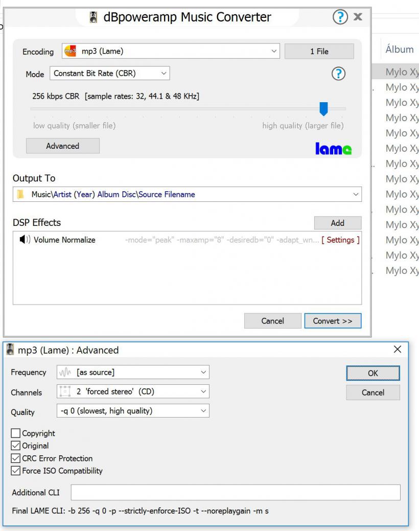

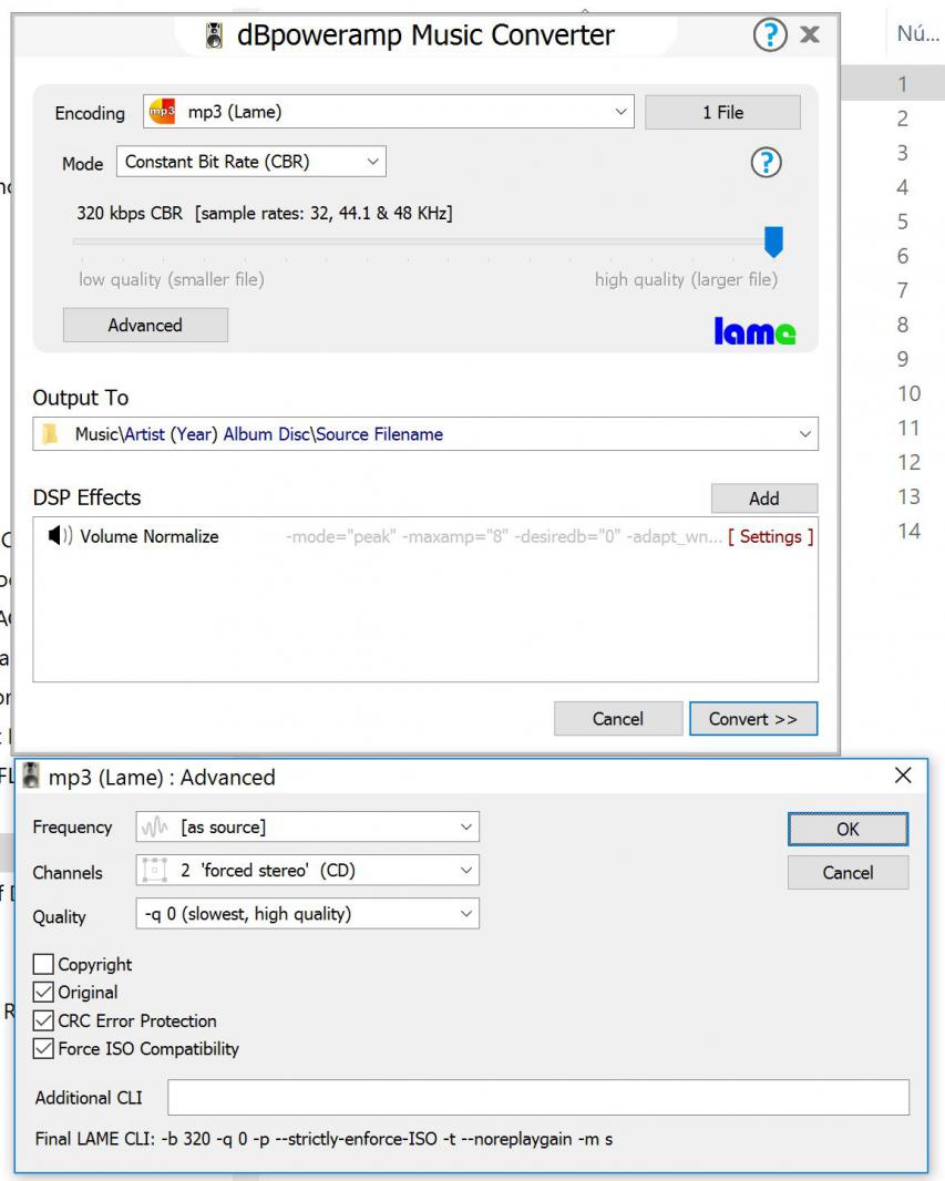

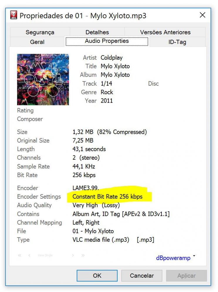

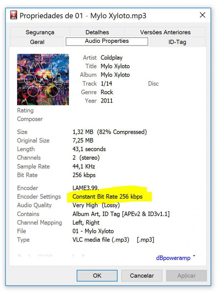

                So...

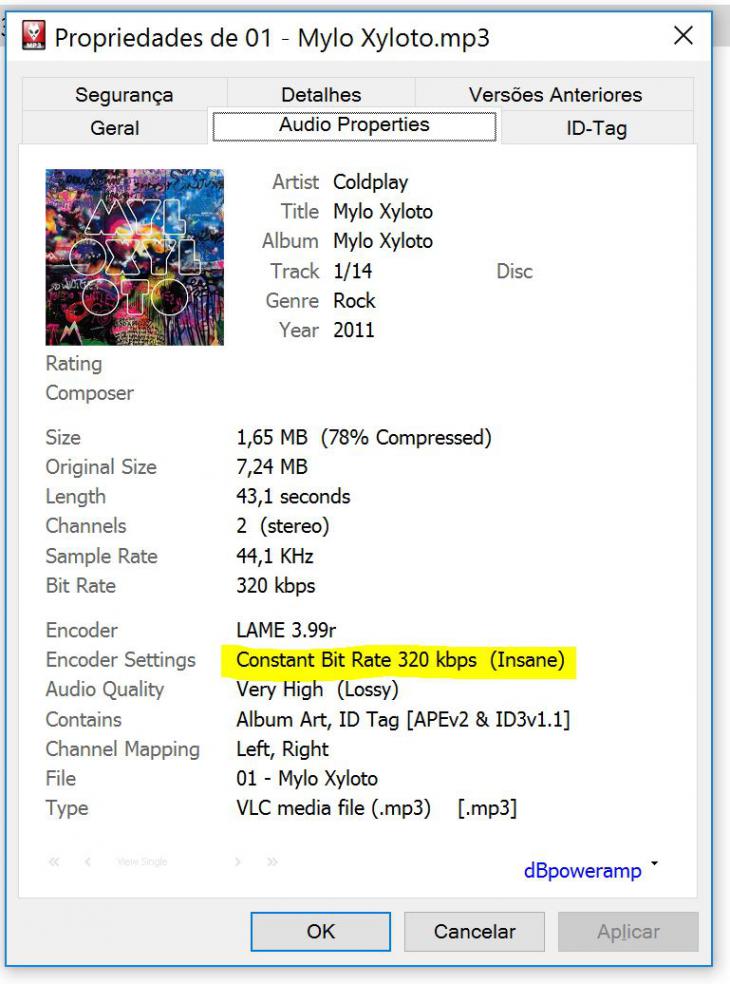

                I create a CLI configuration that gives que desired quality and the files are CORRECTLY converted
                [infile] [outfile] -cbr -b 320 -m s --nohist -q 0 --strictly-enforce-ISO -p
