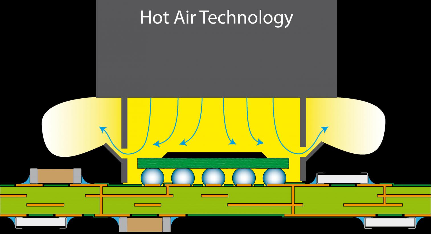

            It still doesn't work:
Name:	TUI013_BGA loeten, 07, BGA beheizen, Heissluft, geloetet-01.jpg
            The black area was the transparent area and it should be white. The corresponding PNG was created by Adobe Illustrator CC.

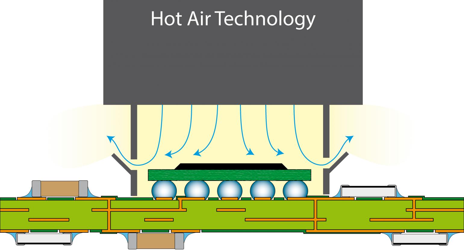

            This was the original PNG file.
            Edit:
            Funny... obviously the website converted the PNG to JPG automatically at the second picture and this conversion worked correctly. One proof more that the dBpoweramp ImageConverter has a bug.
            Edit 2:
            The conversion via Adobe Bridge works fine, too. But the sense of ImageConverter is the quick conversion "on-the-fly" in Windows Explorer.... so I hope you can find a solution. If you need the original PNG file, then let me know how to send.
