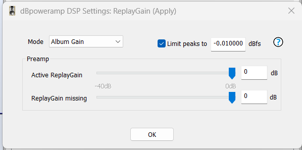

          True but after applying the gain clipping occurs. Now for good news. When I was applying the the gain, Replay Gain (Apply), I was not selecting the Limit peaks option. I thought it was an extra precaution to deal with files from other applications.
          Selecting Limit peaks fixes the problem
Name:	Screenshot 2024-01-29 205246.png
          If peak in dB + gain is greater than 0dB, dBpoweramp recalculates the gain and applies to all tracks in the album.
          Problem solved
