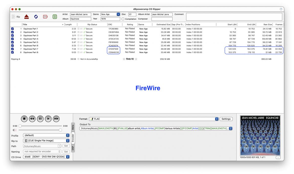

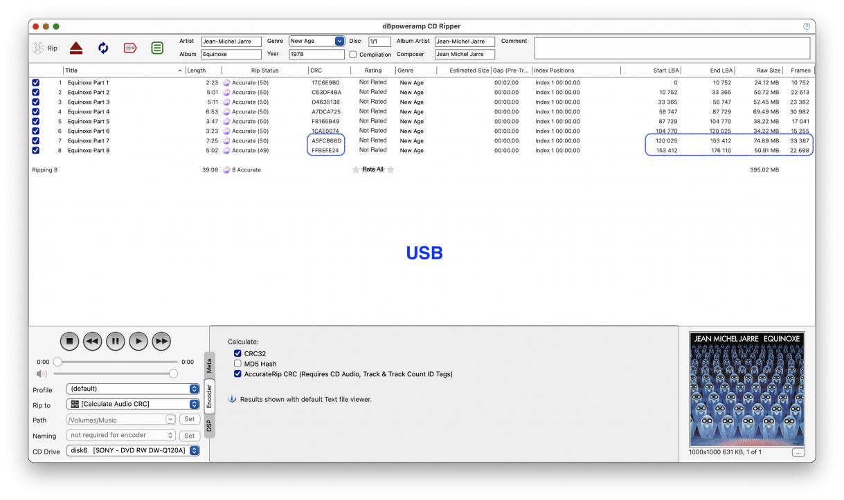

            Further investigation shows that for that particular disc FireWire and USB results have the same disc length but different track indexes for tracks 7 and 8. How is that possible?
Name:	Screenshot 2024-01-10 at 22.53.14.jpg
Name:	Screenshot 2024-01-10 at 22.42.49.jpg
              Re: CDs not in AccurateRip with FireWire enclosure
              It should not be, the TOC is a toc and it should not change, the start times and lengths for the tracks should never change.

                TOC len: 125. First Session: 1 Last Session: 1.
                01 10 00 A0 00 00 00 00 01 00 00
                01 10 00 A1 00 00 00 00 08 00 00
                01 10 00 A2 00 00 00 00 27 0A 0A
                01 10 00 01 00 00 00 00 00 02 00
                01 10 00 02 00 00 00 00 02 19 1B
                01 10 00 03 00 00 00 00 07 1A 41
                01 10 00 04 00 00 00 00 0C 26 2F
                01 10 00 05 00 00 00 00 13 1F 36
                01 10 00 06 00 00 00 00 17 12 46
                01 10 00 07 00 00 00 00 1A 2A 19
                01 10 00 08 00 00 00 00 22 07 25
                1F 00 00 00 00 00 00 00 00 00 00
                Lead out 1: 176110
                Bridge Over Troubled Water FireWire
                % sudo readcd -fulltoc dev=1,2,0
                Read speed: 7056 kB/s (CD 40x, DVD 5x, BD 1x).
                Write speed: 8467 kB/s (CD 48x, DVD 6x, BD 1x).
                TOC len: 158. First Session: 1 Last Session: 1.
                01 10 00 A1 00 00 00 00 0B 00 00
                01 10 00 A2 00 00 00 00 25 1A 2B
                01 10 00 02 00 00 00 00 04 3A 30
                01 10 00 03 00 00 00 00 08 07 1E
                01 10 00 04 00 00 00 00 0B 02 14
                01 10 00 05 00 00 00 00 0D 27 3A
                01 10 00 06 00 00 00 00 11 19 05
                01 10 00 07 00 00 00 00 16 25 3F
                01 10 00 08 00 00 00 00 19 37 08
                01 10 00 09 00 00 00 00 1D 38 3A
                01 10 00 0A 00 00 00 00 20 2A 41
                01 10 00 0B 00 00 00 00 23 00 00
                Lead out 1: 168343
                Bridge Over Troubled Water USB
                % sudo readcd -fulltoc dev=1,0,0
                Write speed: 1411 kB/s (CD 8x, DVD 1x, BD 0x).
                01 10 00 0B 00 00 00 00 23 21 21
                Lead out 1: 168343
                  We cannot add workarounds for a specific faulty drive, sorry.
