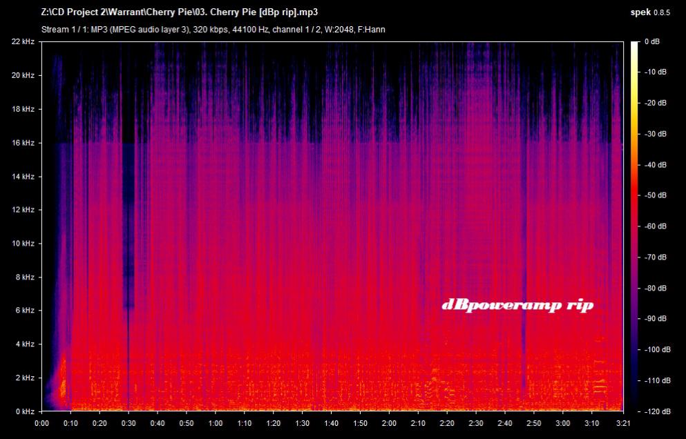

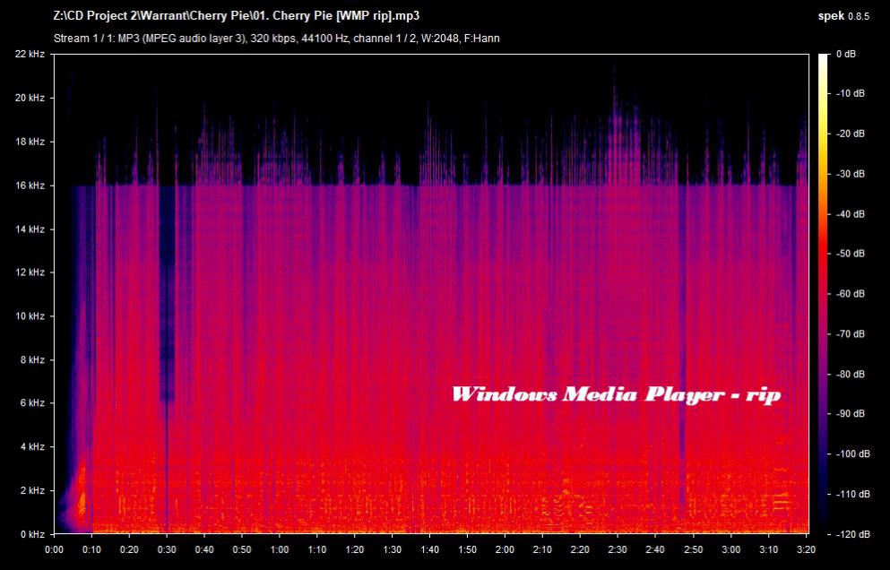

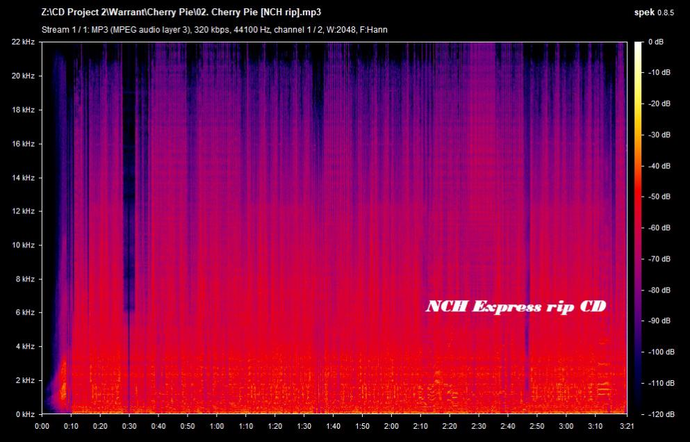

Name:	01. Cherry Pie [WMP rip].mp3.jpg
ID:	294687 Click image for larger version
Name:	02. Cherry Pie [NCH rip].mp3.jpg
ID:	294688 Click image for larger version
Name:	03. Cherry Pie [dBp rip].mp3.jpg
      ripped the same track using three different software. How do I get NCH results with dBpoweramp? It's just that I have that OCD brain that wants to get the absolute very best MP3 possible. It's probably no big deal. I just wanted to know.

        Re: Problem in comparison to NCH ripper when using SPEC
        3.82 is a older version, sorry we cannot supply old versions of lame, dBpoweramp uses 3.100 which has a higher quality.
        I would not use the lowpass option, although it looks better in the audio editor, you do not hear audio with your eyes, 100% certainly the 3.82 and 3.100 with lowpass will be lower quality audio than 3.100 without lowpass.
