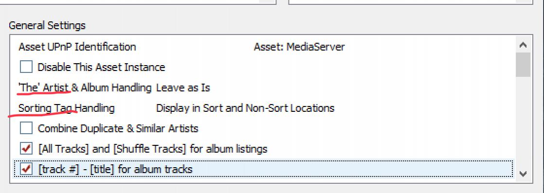

              • GBrown
                • Oct 2009
                • 431
                Re: Artists with 'The" in the title.
                There is a program in the start menu called Asset UPnP Configuration, start that and then click on Edit Advanced Setting. Change the second and third items to match your needs.
