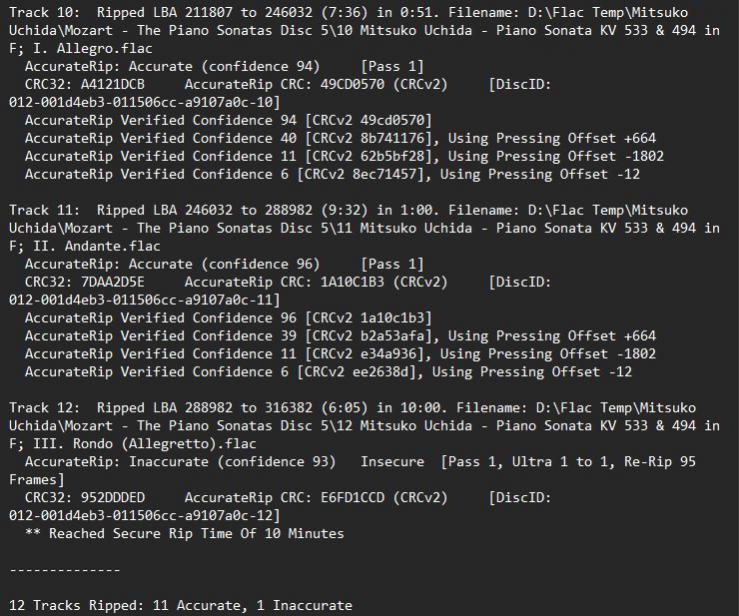

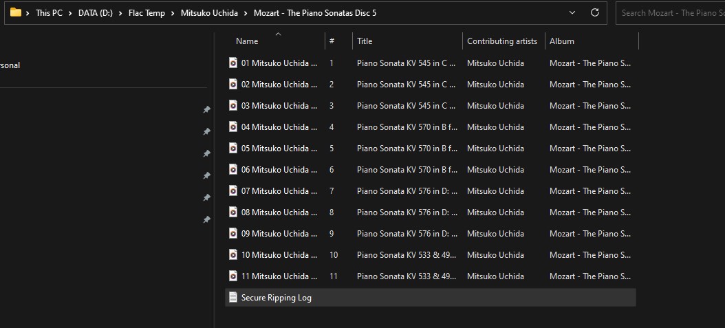

      Please see the pics attached.
      The log says 12 tracks ripped, 11 accurate 1 inaccurate - but the folder where the files go only has 11 tracks...
      Does it put the inaccurate tracks somewhere else?

        Re: Track Ripped Insecurely - how to overcome?
        You have an abort option set, so best to set ripping method to burst and rip that track on its own if secure ripping cannot rip.
          Nice one - Thanks!
          Worked a treat
          Was especially annoyed at that error on the above rip - all good until the last track on Disc 5!!!
