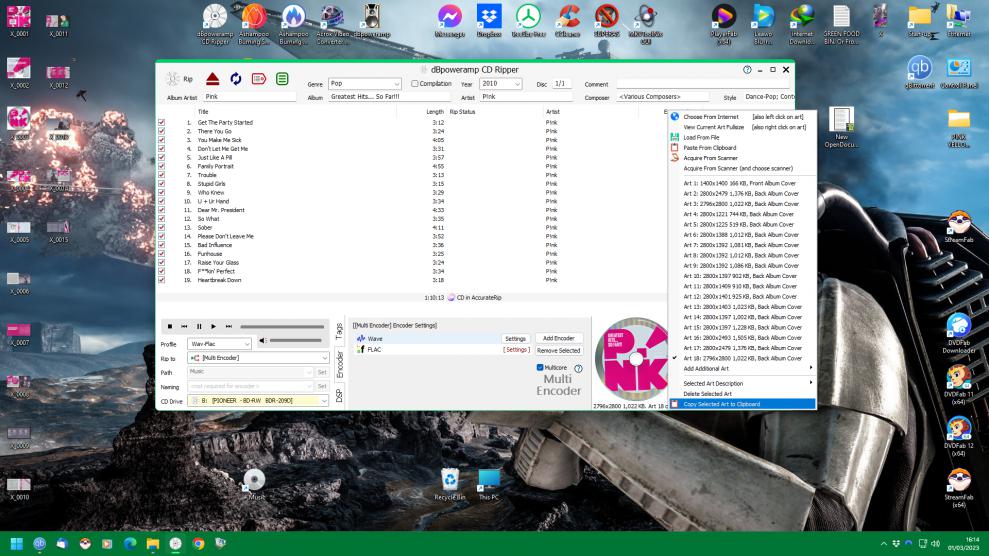

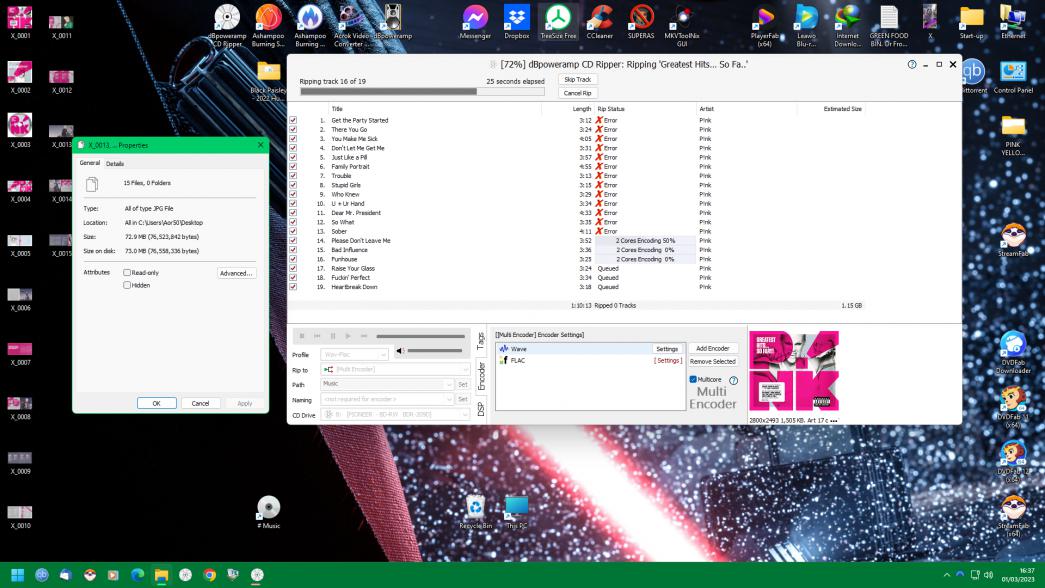

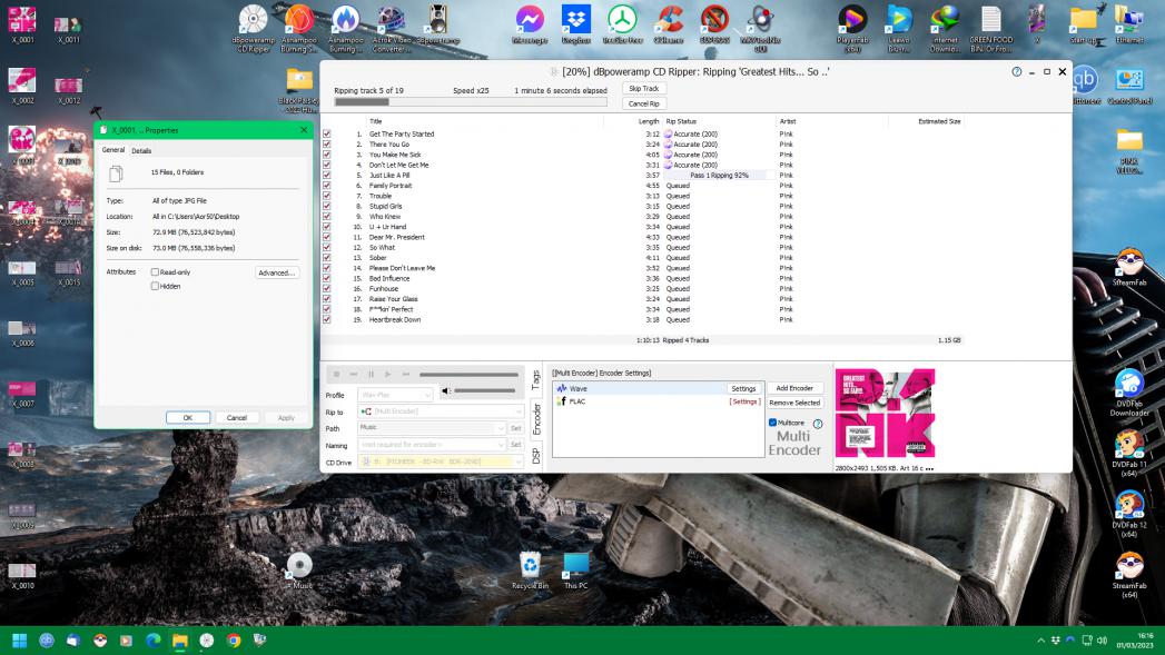

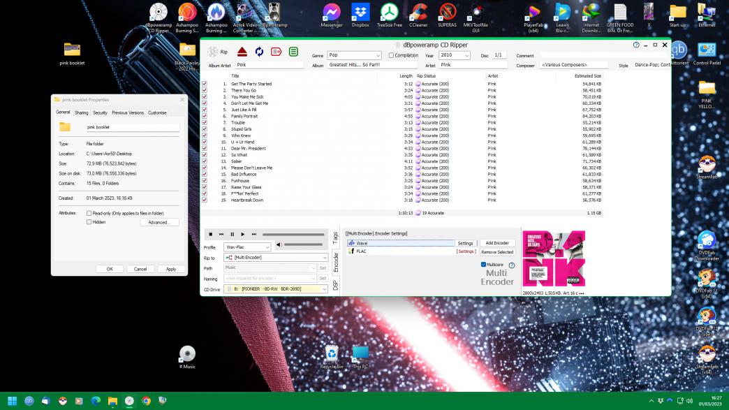

Name:	v17 18 pictures.jpg
ID:	294651Click image for larger version
Name:	v17 73mb in totoal picturea.jpg
ID:	294652Click image for larger version
Name:	v17 complete sucess 16 pictures attached.jpg
ID:	294653Click image for larger version
Name:	v20 same cd same pictures.jpg
ID:	294654Click image for larger version
Name:	v20 same cd same size 73mg.jpg

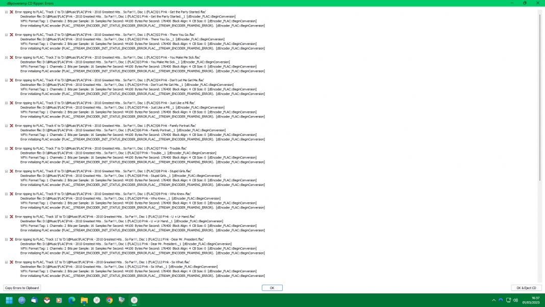

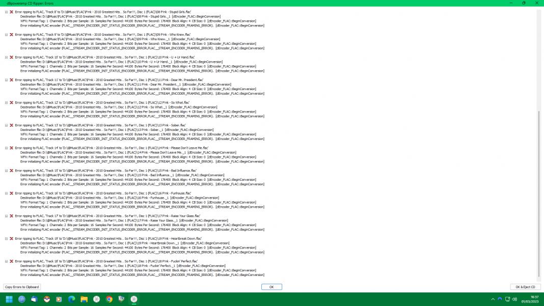

                      Re: Found My Prob With V20 Spoon help ???
Name:	v20 error log 1.jpg
ID:	294656Click image for larger version
Name:	v20 error log 2.jpg
                      and here are the 2 page error log
                      • GBrown
                        • Oct 2009
                        • 431
                        I guess that answer the question. You are trying to store 73MB of pictures into a frame that only supports 16MB.
