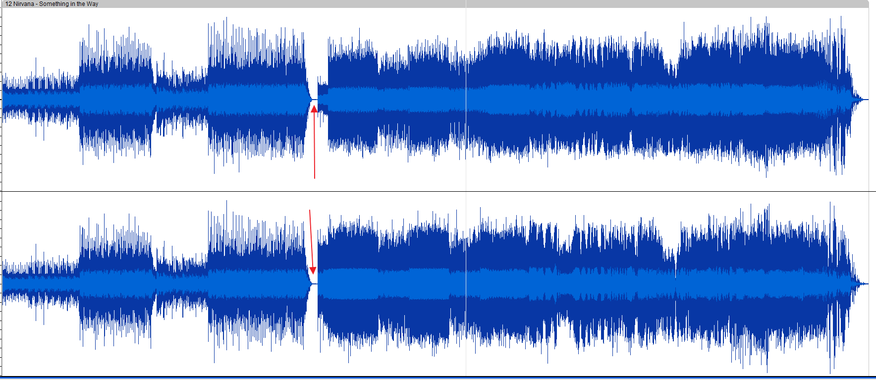

        hi
        I have done as you suggested but the best is have 2 songs joined
        Sad I can't slip them with dbpower cd ripper
        thanks
        a screnshot

          Re: help me please to rip a cd with ghost track
          Originally posted by Drugo
          hi
          thanks
          a screnshot
          [ATTACH=CONFIG]3461[/ATTACH]
          That is exactly what the Remove Silence option does. It removed the 5 minutes of silence. It does not split the tracks. I am not aware of any ripping software that will automatically split while ripping. At best you may find something that can let you manually specify times to split tracks, but this takes a lot of time to figure out those times accurately.
          I would suggest a faster and more precise way is to use an audio editor (Audacity is available for free). It is pretty quick to do this when necessary. But know that once you make any edit, the integrity of the original AccurateRip is destroyed.
