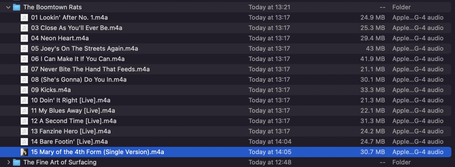

      Thanks for your suggestions. The Denon AV receiver already had the latest firmware and, unfortunately, removing the embedded album art doesn't seem to have made any difference. I used your tag editor to remove the album art from the audio track as suggested, but the album art is still showing against the file when viewed in Finder (but no longer in Apple Music) - is this normal?
