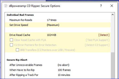

                The C2 Error Pointers for Error Detection setting is per drive, found in CD Ripper Options > Secure Settings.

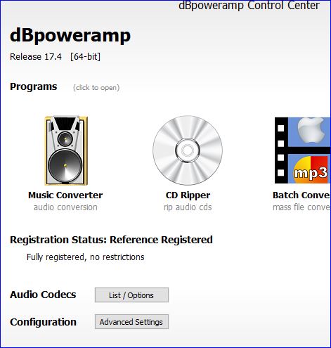

                  I don't seem to be able to access that option. It's greyed out.
                  The docs say something about "Reference required". I do have a "Reference Registered" status.

                    Run dBpoweramp Control Centre, it will show the status of the registration status.

                      I did. It's fully registered. Please see above. I'll try attaching a screenshot.

                      EDIT: Here's a second screenshot, of what I see for C2.
                      I tried a Detect on one CD drive, BTW. It changed the cache size but didn't change the grey-out. I have two different types of drives, does that matter?

                        At the end of that options page is 'communication' it needs to be on SCSI Pass through (SPT)
                        for c2 pointers and alike to work.

                          Thanks Spoon, SPT did the trick! I didn't even have to turn on C2, and it was able to get a Secure read of that wacky track! I'm looking forward to seeing how accuracy works for other CDs now.
                          BTW, I tried SPT + C2 for comparison, it ran extremely slowly on that same troublesome track. 15 minutes or so, just for pass 1 on that single 3:23 track, and it errored out. Speed showed as x0.3. Ugh! I think I'll turn C2 off.
