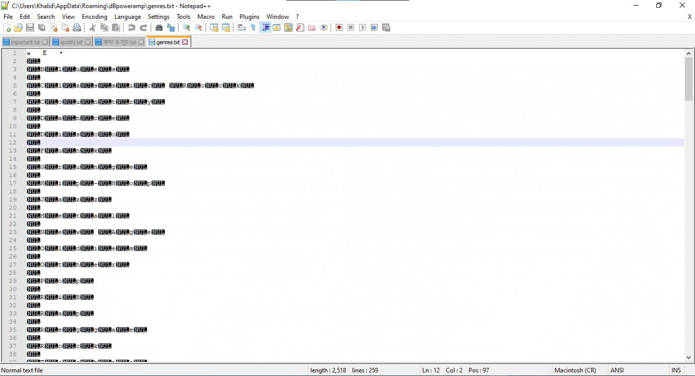

      I am edit with Notepad++
      after write a item in Bangla then save it. then reopen it the file shows like the screenshot

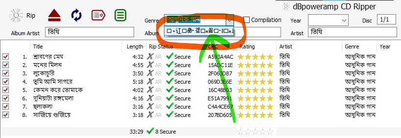

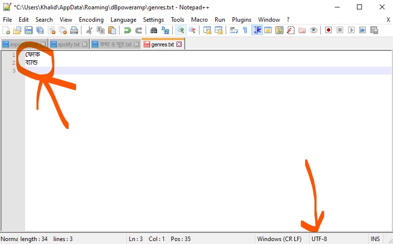

          When I type my custom Genre into the UI field then it's worked fine, But the Genre doesn't store inside the CD Ripper, so when Next time I have tried to rip another CD in the same Genre then I have to Type the Genre again, & again. So I have tried to edit the List from the genre.txt file. This time I have create a New text file in UTF-8 coding & rename that file genre.txt and replace that file into C:\Users\Khalid\AppData\Roaming\dBpoweramp location. But when I Open the UI of CD Ripper the list doesn't show the item I had typed in that file.

          But when I open the new created genre.txt file within notepad then it show the item properly.
            Mhm, that works for me...
            It works for me too if I edit and save the genre.txt in UTF16 LE-BOM mode. If I switch the genre.txt to UTF8, CD Ripper can't show the genre.txt.

              How to create or Edit a text file in UTF16 LE-BOM Mode? with which software?
                • 1914
                Re: How to add custom Genre in CD Ripper Genre List in Bangla?
                With Notepad++. Just switch the coding.
                • khalidhosain
                  • Dec 2020
                  Problem Solved, Thank you so much
