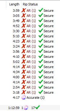

        Does that mean that this is likely to be a good rip (results attached). The drive passed the test for detecting C2 pointers, as described in the Help.
          • 46143
          Re: CD Ripper Results
          There is no way to be certain relying on a single drive to self verify. If you had a 2nd CD drive (different brand) and the AccurateRip CRCs were the same from both then that is a very good indicator.
          For most relying on the drive to self verify is enough.
          • paulch
            • Mar 2021
            • 32
            Thanks. I do indeed have a second drive. I mostly use an external drive, as that passed the C2 test (the internal one didn't). I got the exactly the same results for this CD in both drives, so it sounds like it's ok. The only CDs that I haven't been able to rip so far in either drive are those that appear to have copy protection.
