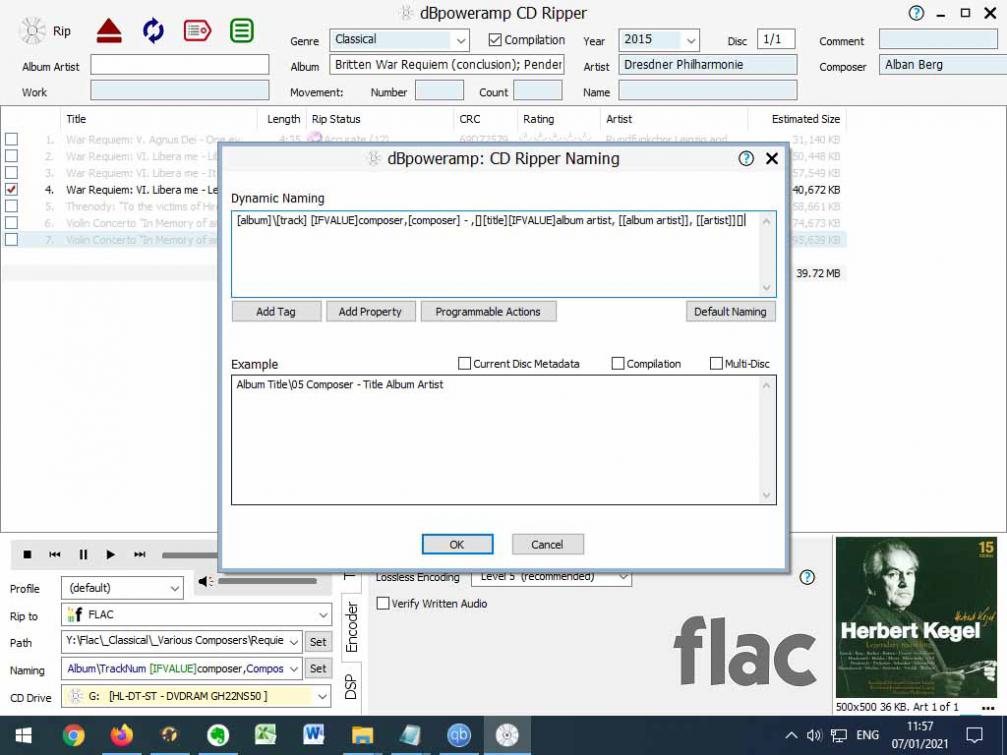

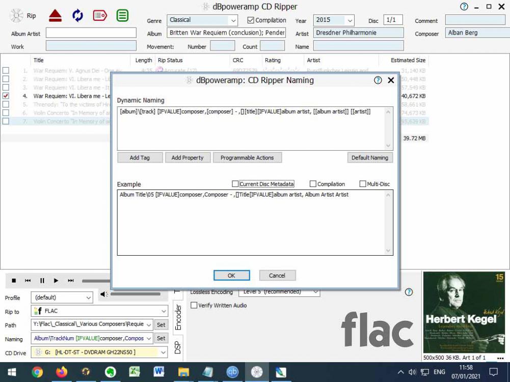

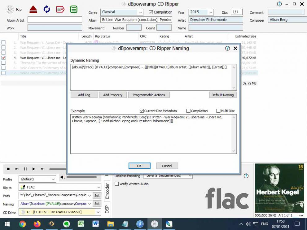

        Hello all, well it seems like I'm having a conversation with myself here!! Anyway, the initial problem with the square brackets is still there. Here are some screen shots showing my formula working on most rips, but then not working (i.e. ending the filename with []) on a specific rip, then showing the simple edit needed to make it work on that CD and then showing that that edit screws everything up on other rips.

        As I said in my original post, I think a solution would be the square bracket equivalent to <comma_> if such a thing exists.
        Thanks for reading... Peter
