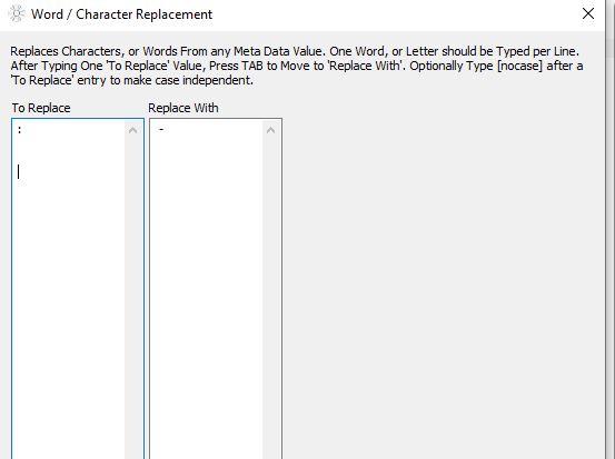

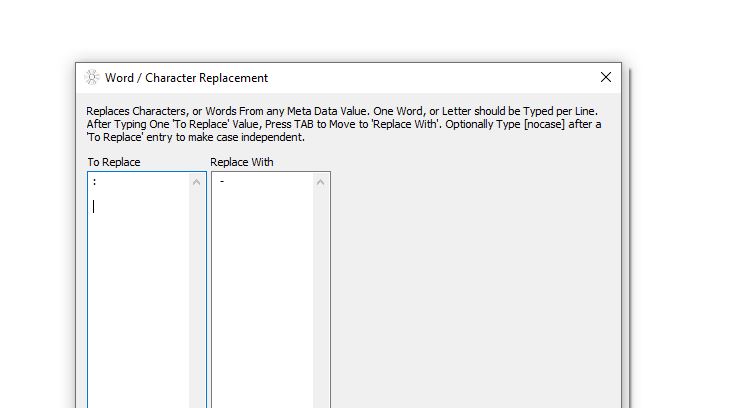

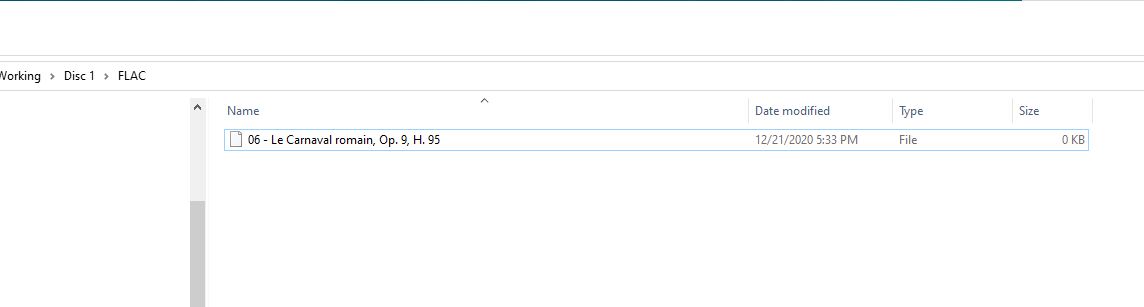

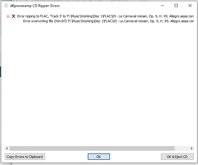

                Yes, that is what I've been trying to say. That no longer works - you get an error on file write, and it leaves a misnamed 0 byte file. See screenshots below:

                  You would have to refresh the disc so the metadata is processed again, I can see you still have ':' in the filename which is an illegal character.

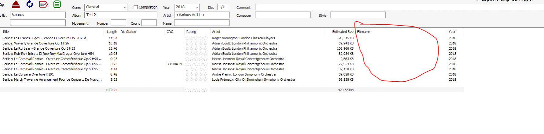

                          I followed your instructions. I enabled the Filename column, ensured that the DSP is correct (screenshot attached), and changed the Album title. What is interesting is that that filename column never changes. It stays blank no matter what change I make at the top (album, artist, year, anything). Screenshot is also attached. So, I guess it is never reading the DSP.
