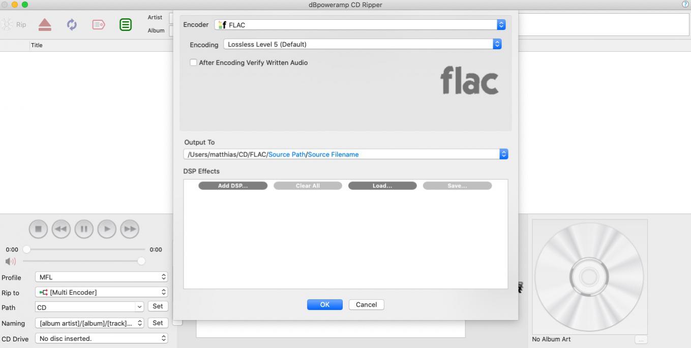

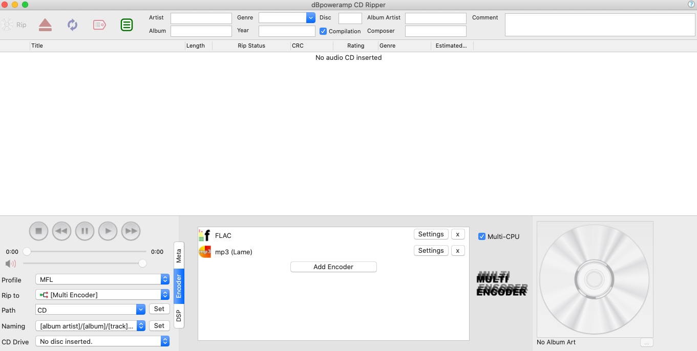

              Please post a screen shot of the encoder pages within multi-encoder

                Re: ripping into multiple formats / directories
                Sure, here it is
                  That is the issue, you are using 'source filename' this has no meaning for CD Ripping because the source is a CD.
                  You would copy the full naming string from CD Rippers naming section and paste it into the multi-encoder naming section.
                      CD Ripper main screen click 'set' next to naming, then copy that naming string to the clipboard.
                      Visit the encoder settings page within Multi-encoder, where it says 'output to' select 'edit' option in the drop menu and past the naming string, ensure the path at the top is correct also.
