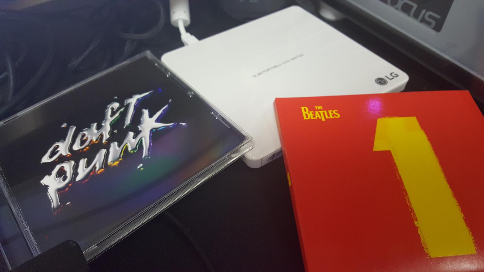

    Hello. I'm using an external ODD and the model is LG's gp62nw60
    And i also using EAC.
    Despite the ODD equipment released in 2018, offset detection using Keydisk is not possible.
    The disks I used are The Beatles 1 and Daft Punk's Discovery.
    Is there anything else I missed other than using the disk in the Key Disks list?
    It's very confusing. I believe someone can help.

    Have you used these CDs before to configure a drive? They could be a different pressing to that in the AccurateRip DB.
      • 6181
      Re: Problem with key disk
      just keep trying with popular CDs. It can sometimes take 10 or 15 disks before it configures. And sometimes only one.

            Hi All, Is there any way to check if my Buffalo BDXL has Read into Lead-in or Lead-out, or do I have to keep inserting disc's to get the configure Accurate rip page up?
            Steve
              • 46078
              They are two separate things, AccurateRip and read into lead in and out. To work out the latter is very difficult and involves mastering a special audio CD.
              To configure accuraterip keep feeding CDs.
