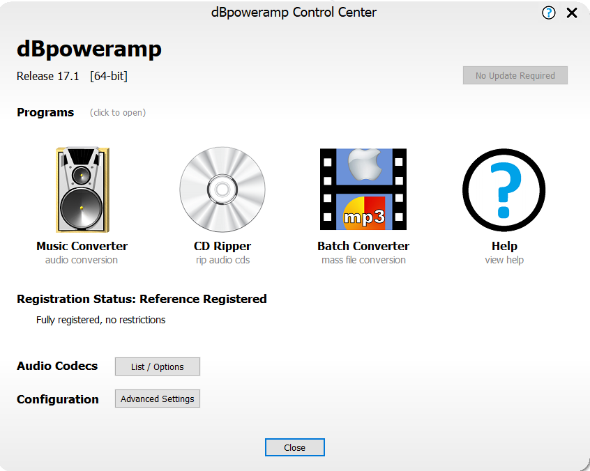

      Re: Multi-core ripping not working with Reference 17.1
      Check you have Reference Registered which is needed for multi-cpu, look at the registration status in dBpoweramp control centre.
      17.1 Reference Registered. Fully registered. No restrictions.
Name:	dbpoweramp registration.png
        • 46160
        Possibly your cd drive is slower than the encoding, so the 2nd cpu core is not required.
        • Joe Florida
          • Aug 2020
          Thanks Spoon.
          That was it. The encoding happened so fast I didn't see that the other core ran the next task.
          Then I ran Music Converter and all 6 cores ran simultaneously.
          Appreciate your help.
