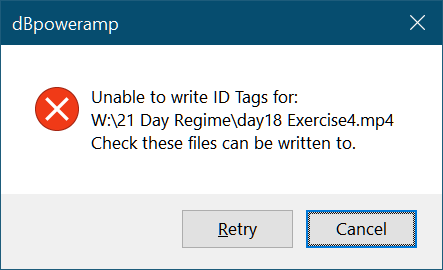

    Running dBpoweramp 17.1, using the context menu feature, Properties window, ID-Tag tab. Windows 10 Home 2004 64bit edition.
    Working with MP4 files. Adding a single ID tag to add copyright information to Comments tag. I have created these MP4 files NEW, all from the same program: Animotica video editor software. I have about an 80% success ratio adding a tag.
    Files are NOT read only, permissions are read/write for everyone. All files have the exact same properties. Fails when updating a single file or multiple using the explorer context feature. I'm not sure which of the programs of the suite are involved, the error message shows dBpoweramp on the title, screenshot: Click image for larger version
    It seems to fail randomly. Since all ~65 files have the same attributes, it seems unlikely it's anything to do with any file specifically. All files are on a shared NAS drive. In the most recent attempt, around 65 files, six failed to update.

    Re: DBPPoweramp - Adding ID-Tag on Properties Window - Randomly fails "unable to writ
    It will be to do with the network share and your computer, if you were to bring the files locally, change the tags I am sure they would write without issue.

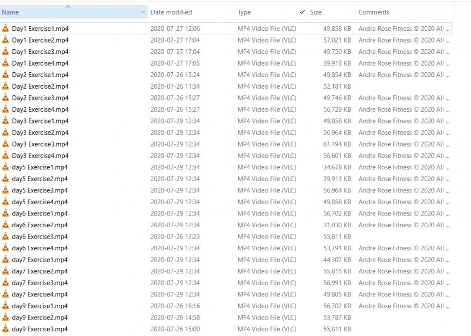

          Yes, I use Windows defender. It's not popping up any warnings, I can try to disable it, but it's not likely to just fail on random files from a list.I attached a screenshot of the folder, I tried to add the comments tag to all these files, the ones that are blank failed. As you can see, it works on most, but those that it fails on will fail for an unknown period of time, then they will work at some random point in the future. Click image for larger version
            If it reliably fails on a certain file, we can take a look at that file.
              Issue confirmed, will look at for the next update.
