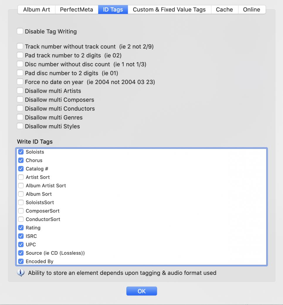

    Re: Help with ISRC codes
    Did you check the opitions ("CD Ripper Options" -> "Tags & Filenames" -> "Meta Data & ID Tag" -> "Options"), that ISRC will be included in the meta data?

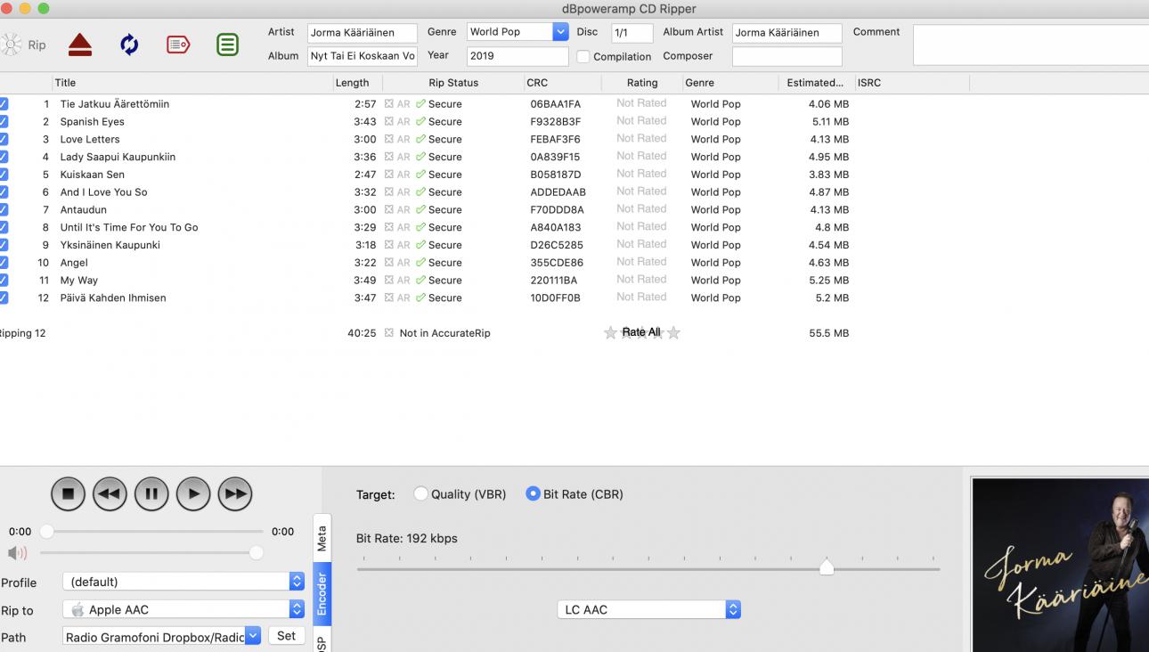

        I have done that i have the field but there is no codes, I know 100% sure the codes are in the cds . i double check those options you mentioned now but seems wierd that software has that isrc option but its not working.Click image for larger version
          Is ISRC enabled as a look up method for metadata?
              Green button on tool bar in CD Ripper >> Active Providers
              ISRC should be enabled.
                Hi , that made it. thx a million.
