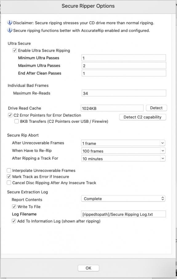

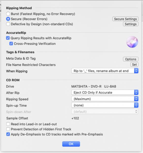

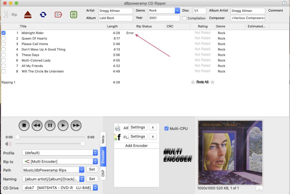

      Hi GaryM -
      Thanks for responding. The log I shared is for the successful rip I did with "Enable Ultra Secure Ripping" [COLOR="*B22222"]not[/COLOR] selected.
      If I enable UltraSecure, then every track shows as ERROR in the main window under the Rip Status column.
      It appears that C2 Error Pointers for Error Detection also needs to be disabled (or I receive errors)
      I just discovered that if "Enable Ultra Secure Ripping" is active but "C2 Error Pointers for Error Detection" is NOT active, it will result in a successful("accurate")rip.
      Below is the Log for a failed rip which shows as ERROR in the Rip Status column in the main app window.
      I've also attached three screenshots of my current configuration.
      Again, if I uncheck (turn off) UltraSecure, then I do not get the ERROR(s)
      (I'm still unclear on what UltraSecure is doing and the advantages of having it activated
      If anyone has any advice on my setting, I would greatly appreciate your input.

      Track 1: Ripped LBA 0 to 20145 (4:28) in 1:41. Filename: /Users/kenheyman/Music/dbPoweramp Rips/Gregg Allman/Laid Back/01 Gregg Allman - Midnight Rider.aiff
      Insecure [Pass 1, Ultra 1 to 1, Re-Rip 9238 Frames]
      ** Aborted: Have to ReRip 9238 Frames, Re-Rip Limit Set to 100 Frames
      1 Tracks Ripped Inaccurately

        Re: Enable Ultra Secure Ripping = Errors
        Try ultra secure WITHOUT use C2 selected. Even for drives that are supposed to use C2 error checking, it often is not implemented correctly. I see this on several of my drives, so do NOT select use C2.
        • Bambooken
          • Feb 2020
          • 16
          That seems to be the ticket!
          Thanks much!

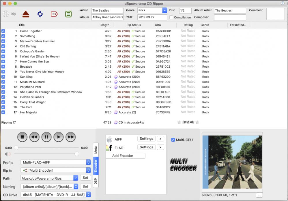

            Everything seemed to be working just fine until this recent CD rip. I understand that when I see the pink disk and the word Accurate, the rip is confirmed (by Accurip). However, some of the tracks show, in red text: AR(200 yet they also show a green checkmark and the word "Secure". What does this mean? The tracks seem to play fine. What's gone wrong (if anything)?
            See attached screenshot.
            Thanks in advance

              • 6189
              it means they ripped "securely" (the multiple dbpa passes during ripping all produced matching CRCs), but they did *not* match the AccurateRip database CRCs.
                Gary -
                So basically I can feel comfortable that the rips are good but Accurip did not have any references to check it with.
                Is this something that is explained anywhere that I missed?
                Thank you for responding so quickly
                  • 6189
                  Originally posted by Bambooken
                  Gary -
                  First, it is a bit odd because typically getting secure but NOT a match happens to all tracks on a CD. But in your case it is only some. But I can say that this happens to me occasionally (it happened yesterday in fact).
                  Second, you might try to rip the CD with a different drive. Sometimes that makes a big difference.
                  Third, this seems to be the Abbey Road Anniversary release. I've seen lots of discussion on the internet regarding how hard that set seems to be to rip and receive AccurateRip results. So perhaps you situation is not that unusual for that CD.
                  Fourth, if it was me, I'd listen to the tracks and make sure I heard no glitches. You probably won't (given secure listing). And if I heard nothing, I'd move on and enjoy the music. Most of my 5000 CD rips are AccurateRip verified, but probably 10% are not and/or have some odd ball results like yours. But audibly they are good.
