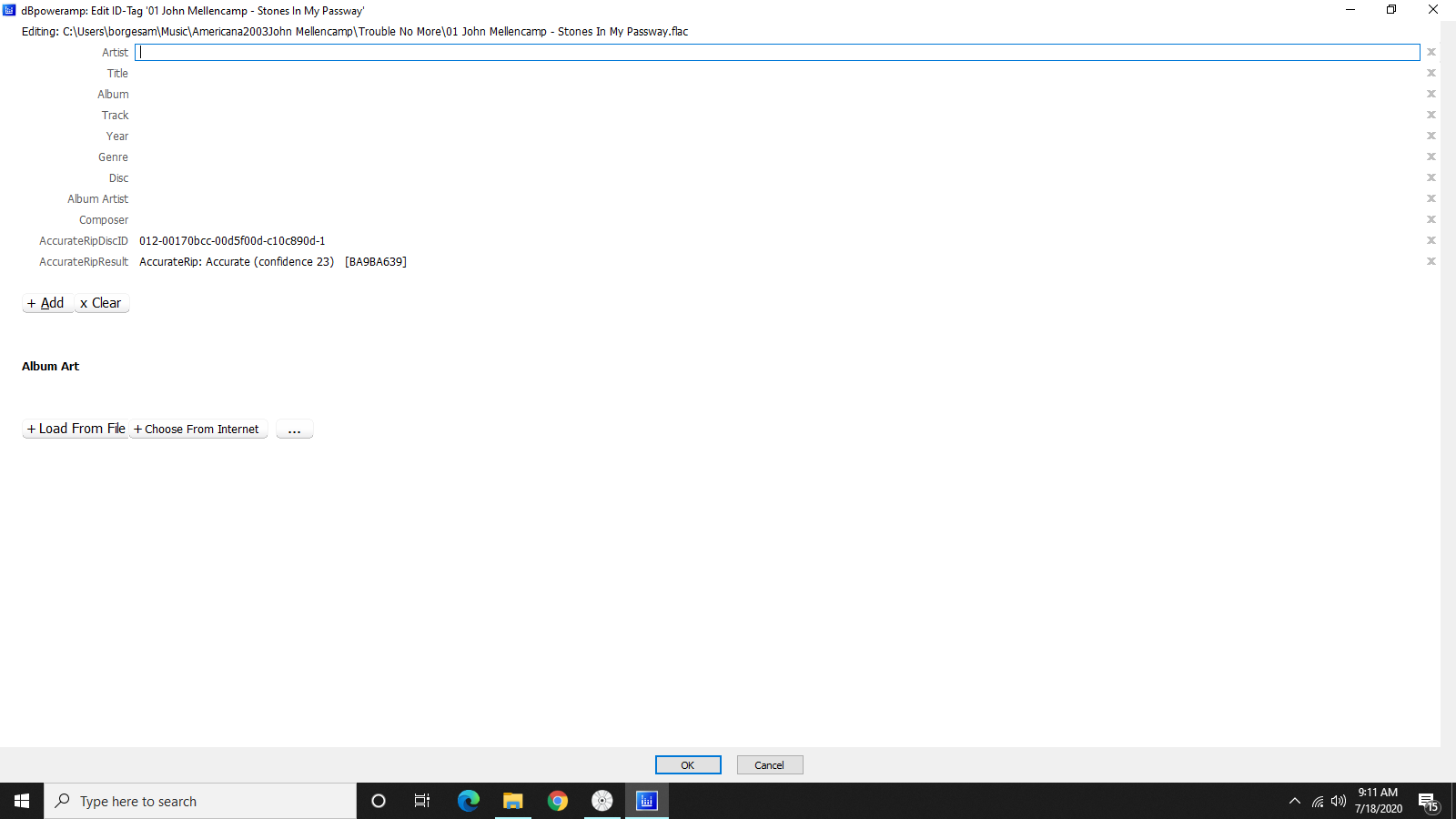

    Right click a FLAC file >> Edit ID Tags
    does any metadata show?

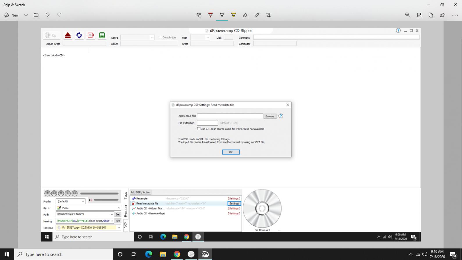

      No metadata and no DSP effects running as best I can tell (See attached screen shots)

        You are running 4 DSP Effects, you should remove them all, remove the Resample, and the read metadata and the other 2 by right click on them and select remove or delete.
