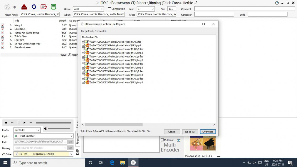

    Ever since I upgraded to the latest version of DBPoweramp, I get an error message when I try to rip CDs. I am attaching a screenshot of the message I receive.
    I tried this a few different times with different CDs but get the same message.
    Can you please advise?

    It isn't an error, it is a message, advising you that you are about to overwrite existing files and, is asking you to confirm the overwrite.
    From the jpg (and the Destination File list), it looks like you haven't configured Naming for each encoder, correctly.

      Re: Cd Ripping error
      Yes your naming string is not correct, it should have [title] in it.

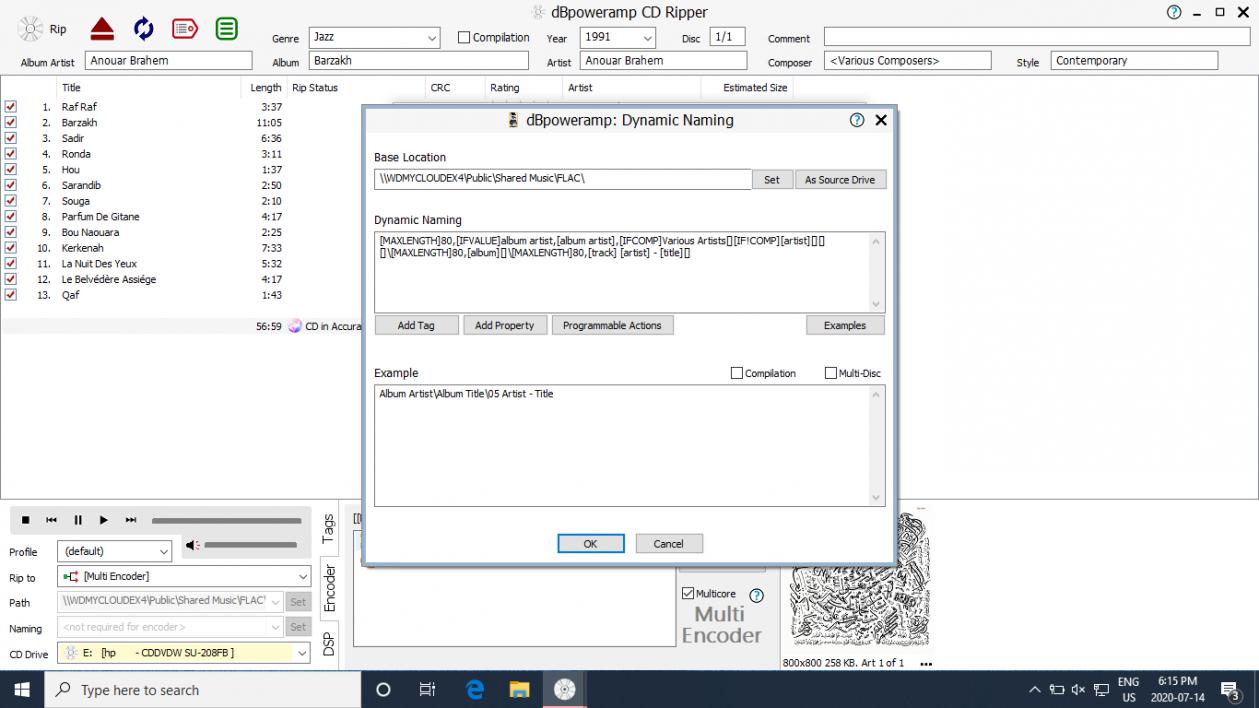

          For each encoder on the multi-encoder page, change the naming string to:
          [MAXLENGTH]80,[IFVALUE]album artist,[album artist],[IFCOMP]Various Artists[][IF!COMP][artist][][][]\[MAXLENGTH]80,[album][]\[MAXLENGTH]80,[track] [artist] - [title][]

            Thank you. I looked at my settings and the naming string appears to be as in your message. What else should I check
              Did you set the naming string within the settings of each encoder or did you set the naming string in the main window?
                  Thanks. The naming string is within the settings of each encoder.
