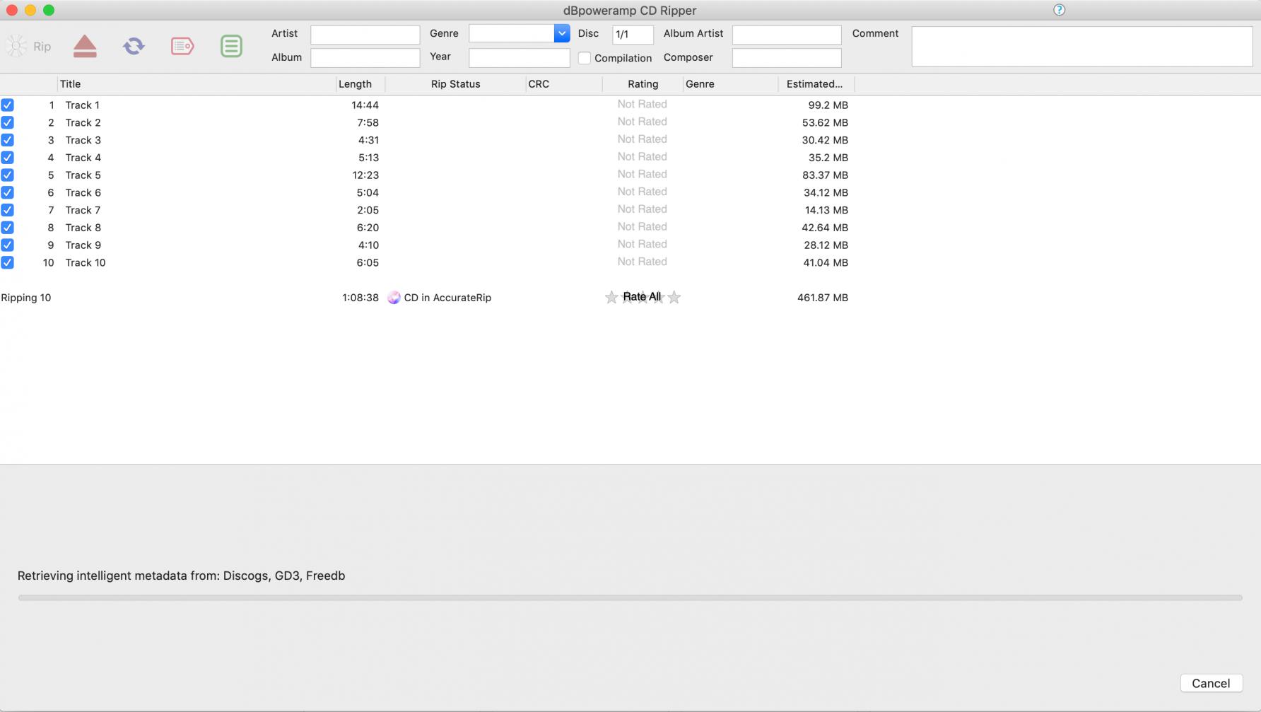

    Bit of a weird one: on my MacPro, Cd Ripper is failing to source metadata from online - just stalls at the beginning of the process, or at the penultimate provider.
    Mojave 10.14.6, dbPoweramp 17.1 beta 5 (1)
    Works fine on the same internet connection with my MacBook Pro 13" running Catalina...Click image for larger version

          ...If I try to trigger a a "retrieve metadata search" from a particular provider (e.g. GD3), app pizza wheels and has to be Force Quit

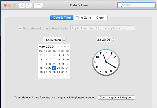

            Checked the computer time and date?

              Re: Failure to retrieve metadata
              Looks good to me

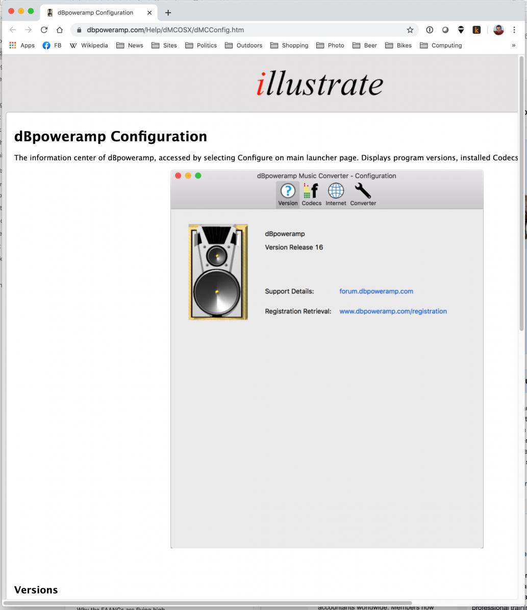

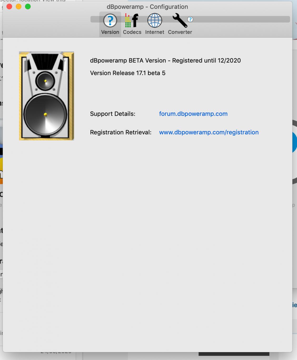

                  Thanks. When I go to advanced setting and attempt to click on the converter tab, there is a bug (greay bar across all the tabs see screenshot), and instead I just get linked to the help page (screenshot)Click image for larger version

                    • 1645
                    Thanks for the bug report.
                    New beta version posted-
                    Current version: beta 15 https://www.dbpoweramp.com/beta/DMC-R171b15.dmg Changes since R17: Fixed launcher window not working correctly on Mac OS Yosemite. CD Ripper: Fixed de-emphasis not being correctly activated on CDs with pre-emphasis. CD Ripper: Added de-emphasis toggle. CD Ripper: More readable output codec list (re
                    The help button should no longer overlap other title bar content.

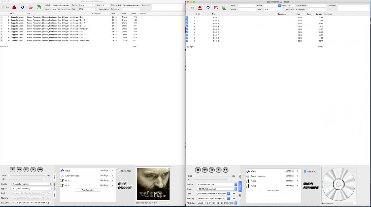

                        Using 17.1b9. Intelligent Metadata lookup does not work correctly. Pls find a screenshot compare v.17.1b9 v.16.5, which I believe to speak for itself in this respect
                          [ATTACH=CONFIG]2818[/ATTACH]
                          Same problem here, every time. With v.17 I have to manually relaunch metadata search. I also have v. 16 and it works fine.
