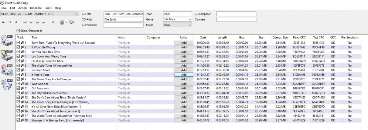

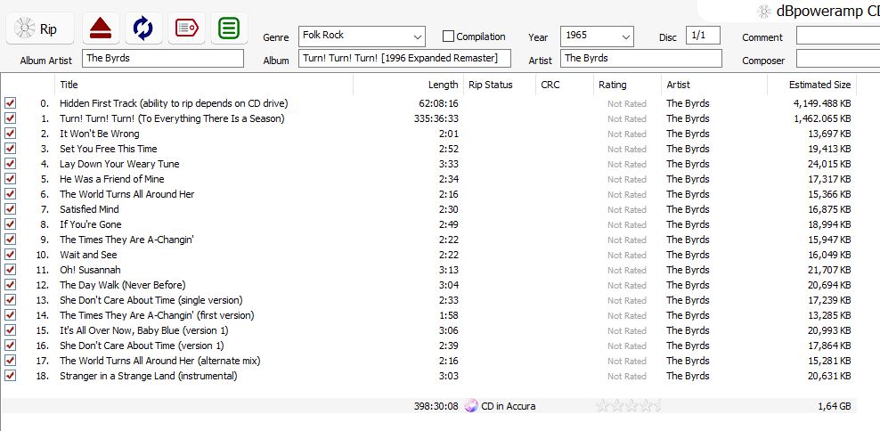

    Hello all,
    I am trying to rip The Byrds - Turn! Turn! Turn! [1996 Expanded Remaster].
    The first track is supposed to have a duration of 3:53 but shows up in dBpoweramp with a length of 335:36:33. dBpoweramp also does show a hidden first track with a length of 62:08:16.
    As far as I know there shouldn't be a hidden first track. Exact Audio Copy doesn't show the hidden first track and a normal length for the first track. The disc ripped perfectly with EAC, all tracks were ripped accurately.
    I have never seen this before. I ripped hundreds of CD's with dBpoweramp including disc's with a hidden first track.
    My question what's going wrong here? What's causing this ?
    See below the screenshots for both dBpoweramp and EAC.

        Track 1 can't be ripped with dBpoweramp with all 3 ripping methods (secure, burst and defective by design).
        The log does say:
        Track 1: ERROR Ripping LBA 16777203 to 17515 (335:36:33) in 0:00. Filename: D:\01 - Turn! Turn! Turn! (To Everything There Is a Season).flac
        The Log from EAC does say:
        Track 1
        Filename D:\01 - Turn! Turn! Turn! (To Everything There Is A Season).wav
        Pre-gap length 0:00:02.00
        Peak level 93.3 %
        Extraction speed 5.1 X
        Track quality 100.0 %
        Test CRC 80481132
        Copy CRC 80481132
        Accurately ripped (confidence 45) [C4EC4953] (AR v2)
        Copy OK

          Strange is that with dBpoweramp the ripping of track 1 starts at sector 16777203.
          With EAC is starts at 0.
          See below the TOC of the extracted cd from the EAC log:
          Track | Start | Length | Start sector | End sector
          1 | 0:00.00 | 3:53.40 | 0 | 17514
          2 | 3:53.40 | 2:01.72 | 17515 | 26661
          3 | 5:55.37 | 2:52.65 | 26662 | 39626
          4 | 8:48.27 | 3:33.63 | 39627 | 55664
          5 | 12:22.15 | 2:34.15 | 55665 | 67229
          6 | 14:56.30 | 2:16.62 | 67230 | 77491
          7 | 17:13.17 | 2:30.20 | 77492 | 88761
          8 | 19:43.37 | 2:49.10 | 88762 | 101446
          9 | 22:32.47 | 2:22.00 | 101447 | 112096
          10 | 24:54.47 | 2:22.68 | 112097 | 122814
          11 | 27:17.40 | 3:13.22 | 122815 | 137311
          12 | 30:30.62 | 3:04.20 | 137312 | 151131
          13 | 33:35.07 | 2:33.38 | 151132 | 162644
          14 | 36:08.45 | 1:58.22 | 162645 | 171516
          15 | 38:06.67 | 3:06.70 | 171517 | 185536
          16 | 41:13.62 | 2:39.05 | 185537 | 197466
          17 | 43:52.67 | 2:16.05 | 197467 | 207671
          18 | 46:08.72 | 3:03.53 | 207672 | 221449
            Re: Extreme large first track
            Try enabling the Prevent Detection of Hidden First Track option.
              That doesn't work. Track 1 still appears with a length of 335:36:33

                      • 46198
                      dBpoweramp reads the TOC with a different ATAPI command to EAC (we ask for in LBA, eac asks for in minutes:seconds), I have seen a drive with buggy firmware give different tocs depending on which call is made, where obviously the same toc value should be returned.
                        Thank you very much for your answer Spoon.
                        So the disc is fine but it's the drive's firmware that's messing up ?
                        It doesn't appear to be a big problem as I ripped over 100 cd's with this drive and it's the first time that this problem occurs.
                        For these kind of problems it's good to have both dBpoweramp and EAC.
                          • 46198
                          Yes
