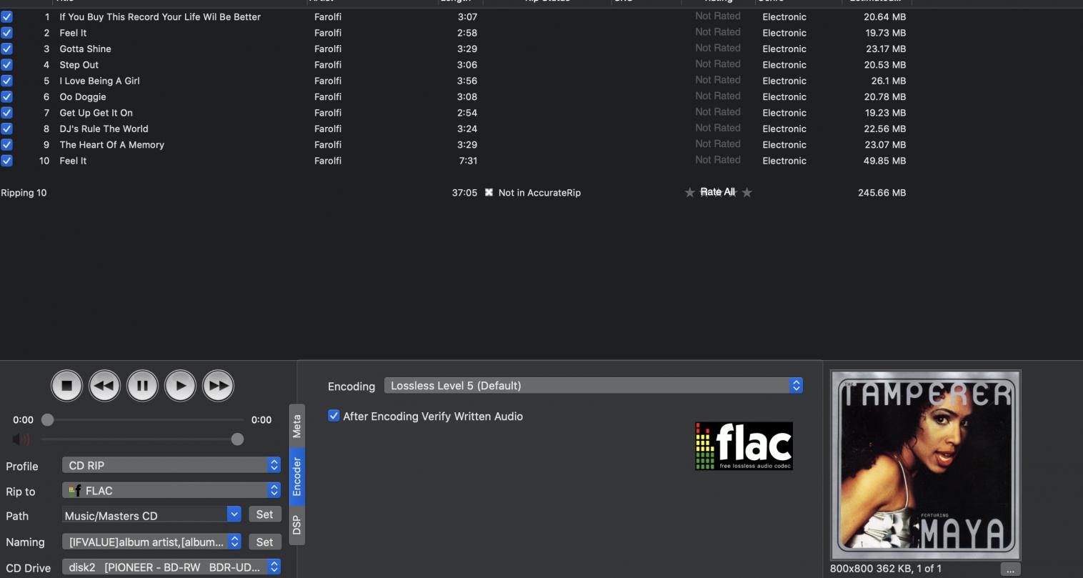

          Re: Long pause at 99% when ripping
          sorry but I did not fund this option, where is?
          anyway I don't think the is the problem but accuraterip must be offline because NONE of my cds are in accuraterip db
            Choose the encoder as 'Test Conversion'
            Which security software do you have? AccurateRip is not offline, if it was you would not reach this forum as they are on the same virtual host.
