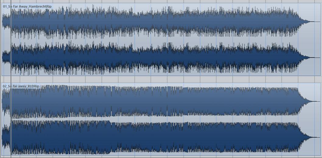

              Now I got his audioexamples.
              I realize that his CD rips are almost 7dB louder. Totally overcompressed. He claims to have used nothing but XLD CD-Ripper.
              But XLD works with the help of iTunes. His ripped CDs has Metadata form iTunes_CDDB.
              So I'm wondering how this man can get this completely over-compressed Ripps.
              Top picture of us. Bottom picture from the customer.

                interesting. Not surprising he thinks his rips sound better (in blind tests, even small increases in volume have led to listener's rating it as "better"). Very odd though, as unless his ripper is doing some sort of Volume adjustment to the ripped audio, the two FLAC files should be bitperfect equal.
                  • 46198
                  Re: Quality question at FLAC
                  It is interesting how he prefers the dynamically compressed audio which is clipping...
                    It looks to me like his rips are adding +6dB and so doubling the amplitude.
                    If the customer is confident and willing, he might be able to explain the differences between your dBpoweramp rips and his XLD rips here, in this thread?
