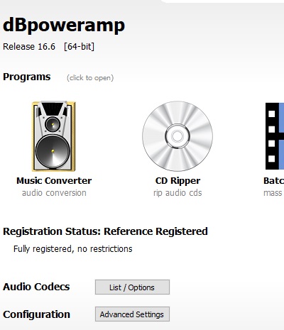

        See if dBpoweramp is reporting as Reference, you can run control Center and it should say Reference: Registered.

          Re: odd metadata lookup problem (Win 10, 16.6 reference)
          Yes - it says "Registration status: Reference Registered", and underneath "Fully registered, no restrictions"
          hopefully the markup above links to the screenshot I uploaded... (?)
