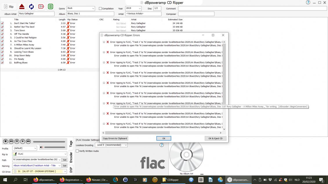

                    happens as expected, error when I started up hs morning trying to rip a ( new) cd.
                    Made a copy of the message. Hope you have a solution.

Name:	Schermafdruk 2020-02-20 11.23.20.jpg

                      Let me guess: N:\ is a network drive.

                        it's the ( home) network link to a folder on my NAS
                        Now first changed the path to a folder on my laptop, ripped 1 cd, ok. Then changed the path again to the N-drive, ripping ok. Can you explain? How can I arrange things in a proper way?

                          The drive is not ready or not connected, when you start to rip. From my point of view this is the reason, why CD Ripper can't open the file. Make sure the drive is connected, not in stand by and accessible, when you start to rip.

                            Thanks for the thinking, after changing the paths it seemed indeed quite obvious, I was going in the same direction. You mentioning the N-drive , that's the clue!
