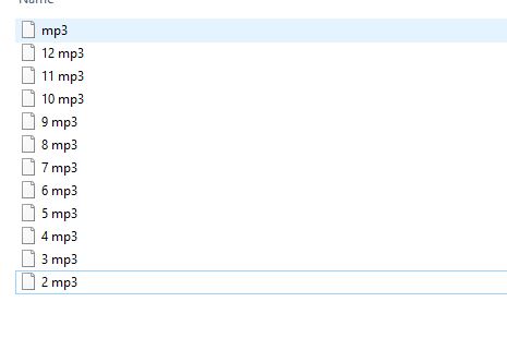

    This used to work... ripping to 320kbps and FLAC into two separate folders. The data seems to be there because of the file size but as you can see something isn't right. Any ideas?

    You have extenstions showing? because you would expect:
    3.mp3
    not
    3 mp3 as in your image

      It does fine if I choose a different profile. Any idea what's causing this? It does not tag or put the "." between the extension.
