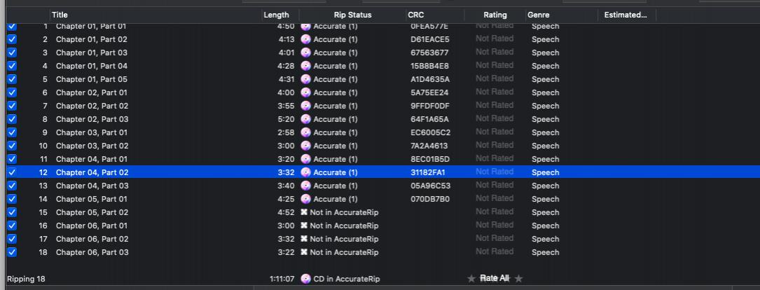

              I tried another optical drive, and this time the tracks were ripped but came out as inaccurate. The ripper also reported that the tracks were not in the Accurate Rip Database, which is weird, because the preceding tracks were all listed as Accurate and the CD is listed in as being in the database (see screen grab). Is this a pressing/manufacturing issue? Click image for larger version

              Just to be clear, what do the terms "inaccurate" and "insecure" mean, precisely? What is the difference between the two?
              And what is the difference between "secure" and "ultra secure"?
              Finally, does burst mode ripping mean that the ripper emulates a CD player?
              Thanks for all the help! It's much appreciated.
                Re: Issues ripping audiobook CDs
                Statuses are listed here:
                Ultra secure just tries more times to spot errors, most people do not need this.
                Burst accepts what-ever the CD drive produces, small errors tend to be interpolated to silence by the drive.
                  The other person might have had rip errors on the last tracks, hence why they are not in the database.
