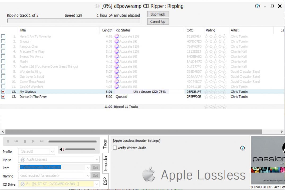

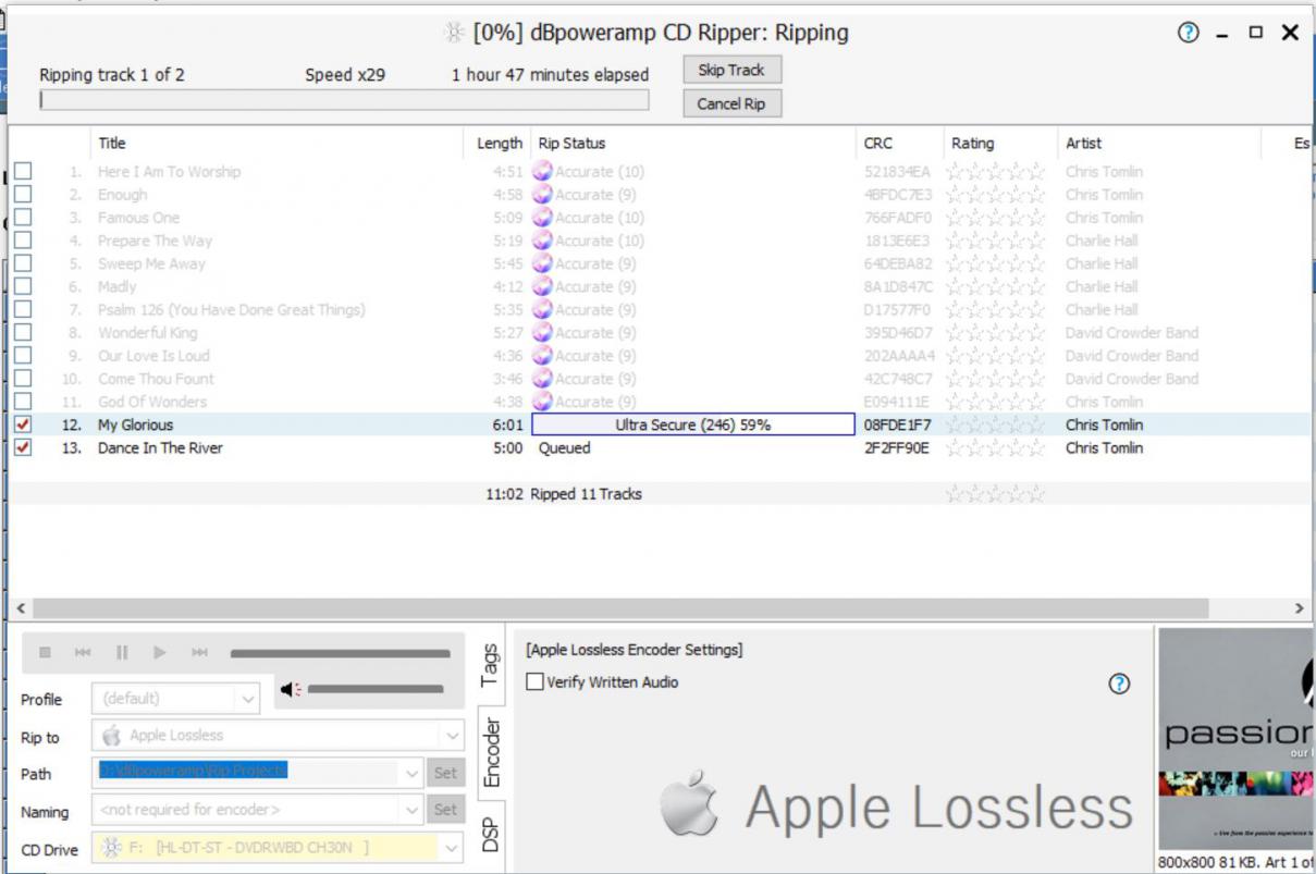

      2. Expanding the column did not cause a change to the presentation, it continues to wrap around and restart the count. I'll see if I can't identify the exact number that it loops on. It appears to be somewhere between 240 and 350 secure rips.

        You can post a screenshot of number 2?

          Sorry for the delay, here is an example.
          The rip was set for 800 Ultra Secure Rips and I was able to capture screen shots right before and after it reset the rip count. I didn't see it actual roll over and reset, but it looks like it was near the 250 rip count.
