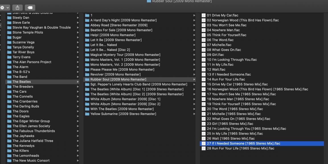

    Hello, I ran PerfectTUNES AccurateRip on my USB music drive and found a bunch of track errors. Most are are just 1 or 2 tracks of an album. I re-ripped just the track that had an error, deleted the bad track on the USB drive, and then copied the replacement track to the USB drive. When I run AccurateRip on the USB drive Album folder, it only reports 1 Track Accurate instead of all 28 for instance. Before I replaced the bad track, it showed 27 accurate and 1 track with an error. Is this normal behavior?
    I'm on Mac OS 10.15.1, PerfectTUNES 2.3, dbpoweramp Music Converter 16.6(1).
    John

      Re: Replacing AccurateRip Files Quirk
      Thanks! I believe you are correct. I was not paying close attention. The Album title and song name changed. It's a remaster with info in brackets [] and that was different. I corrected those things in the CD Ripper and while it looks like the originally ripped track, the issue remains.
          Deleted the file, ran AR which reports Cannot Check: Incomplete Album, copied the corrected names file into the folder, ran AR which then reports 1 Track Accurate.
          Does metadata within the file affect it? Here is a screen shot with the replaced file highlighted:
            [ATTACH=CONFIG]2531[/ATTACH]
            Not sure, but make sure that the album level tags in all the tracks of the album are identical. Album name, discnumber, totaltracks, totaldiscs, comments, compilation (if ticked), etc. Easiest way to do this is to load all tracks of the album up in your favorite tag editor (dbpa or whatever), select all the files, then you can easily see if any tag fields differ across the album.
              Thanks, garym! That was it. I appreciate your and Spoon's help! I'm clearly clueless but hopefully can get back on-track correcting the rest of my rip errors.
