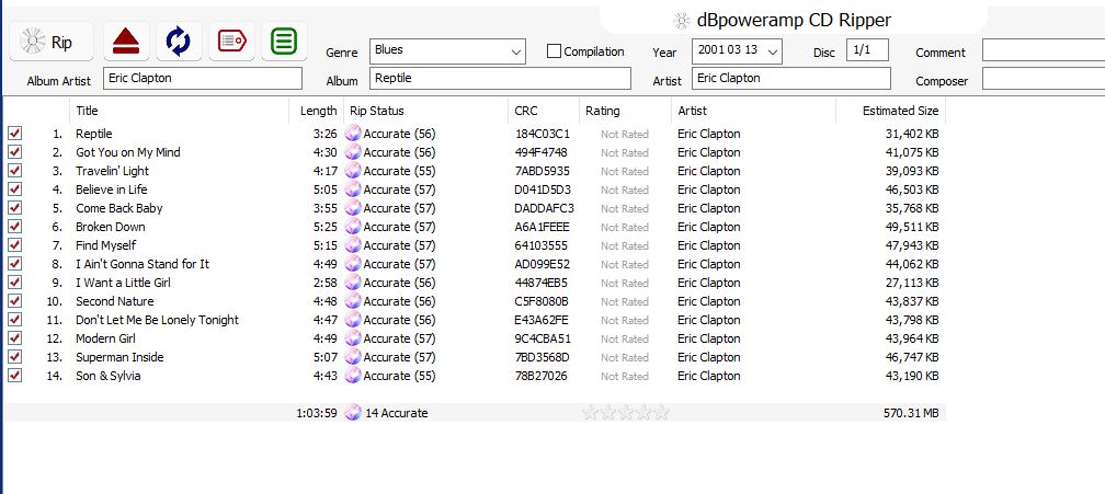

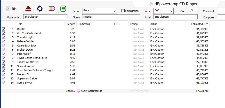

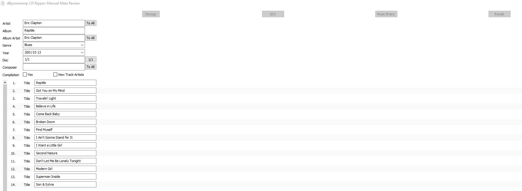

      Upon restart, results were displayed on the main screen (1.jpg), 'Review Metadata' screen was blank (2.jpg).

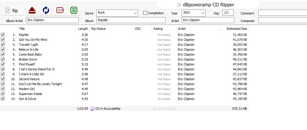

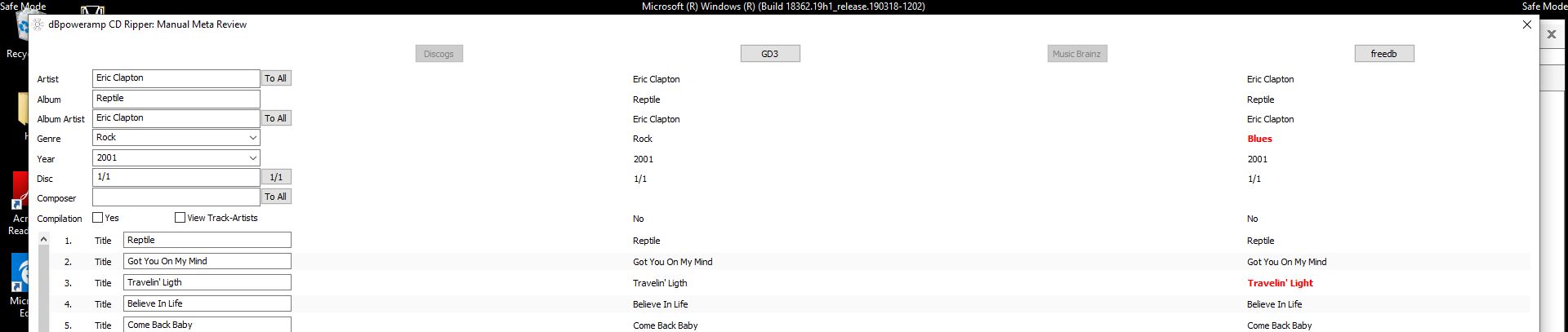

      Did a re-scan and re-read, this time it took 2 minutes and 55 seconds (3.jpg), 'Review Metadata' screen contained info from 2 providers (4.jpg).

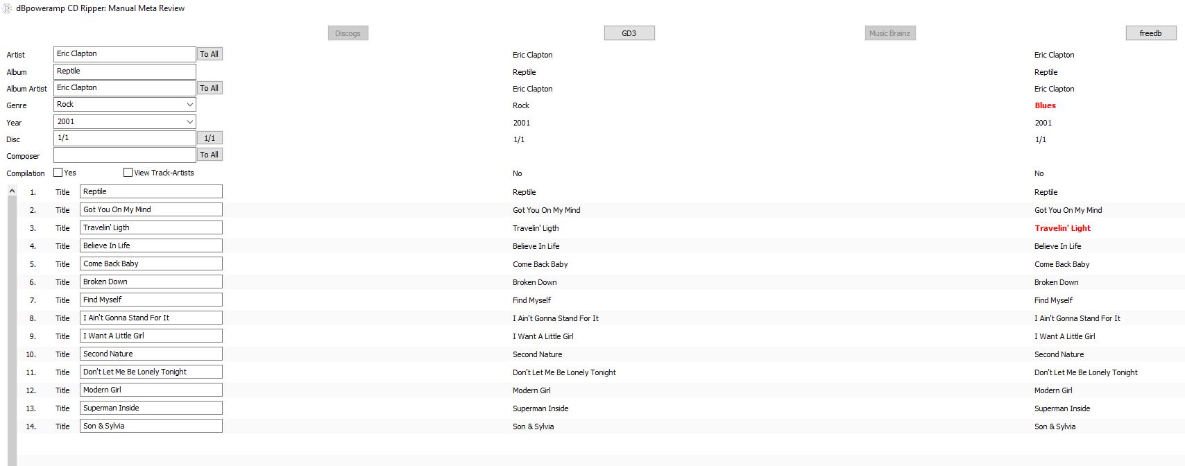

      Did another re-scan and re-read, on the third round it took 2 minutes and 53 seconds (5.jpg), 'Review Metadata' screen contained info from 2 providers (5.jpg).

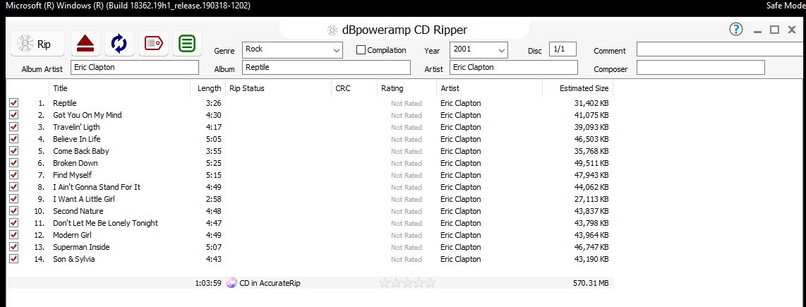

          OK, running in safe mode w/networking had the same results, around 3 minutes to retrieve data, see 7.jpg and 8.jpg attached.
          Looking at the 'Review Metadata' screen got me thinking, so I deselected those 2 providers (Discogs and Music Brainz) that returned no data, cleared track data, re-scanned and reread, results in under 4 seconds. Repeated this multiple times, all with the same results, Metadata retrieved under 4 seconds.
