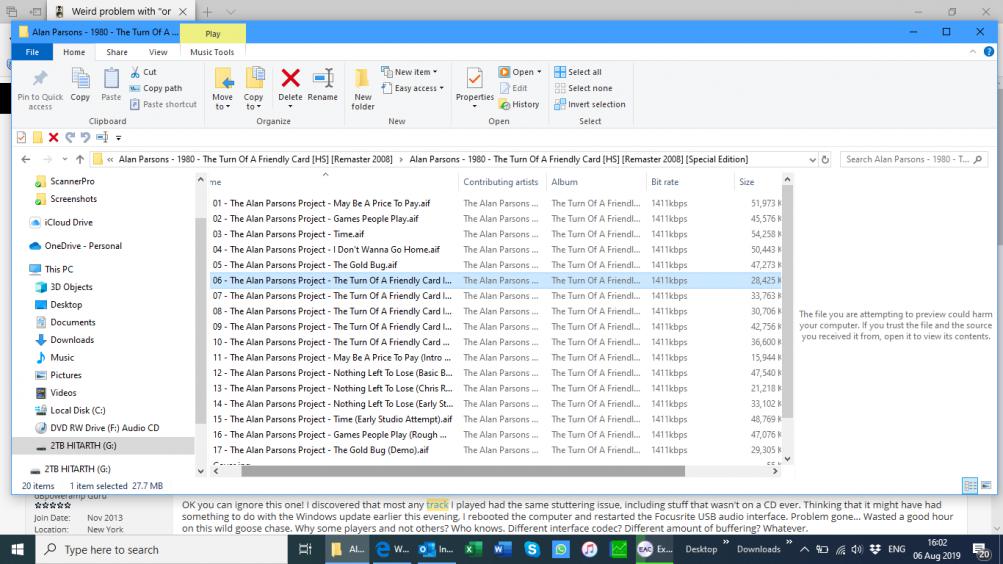

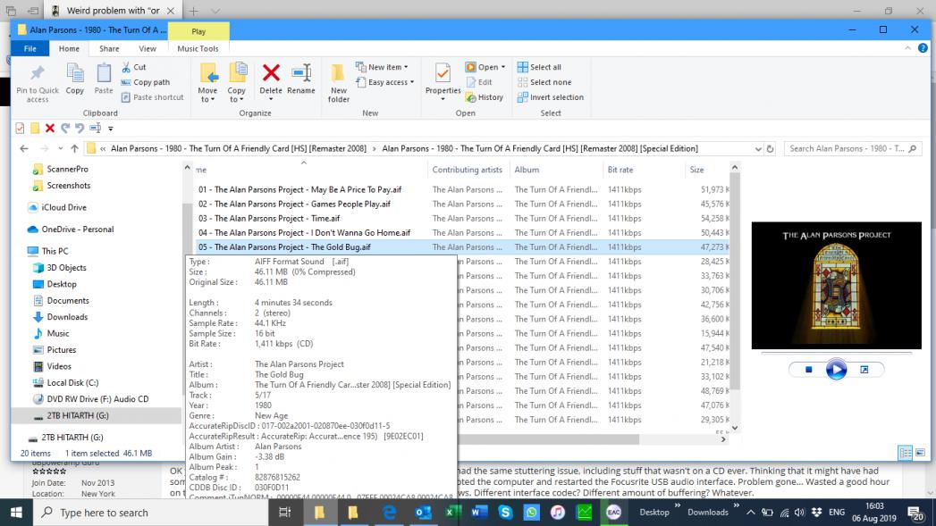

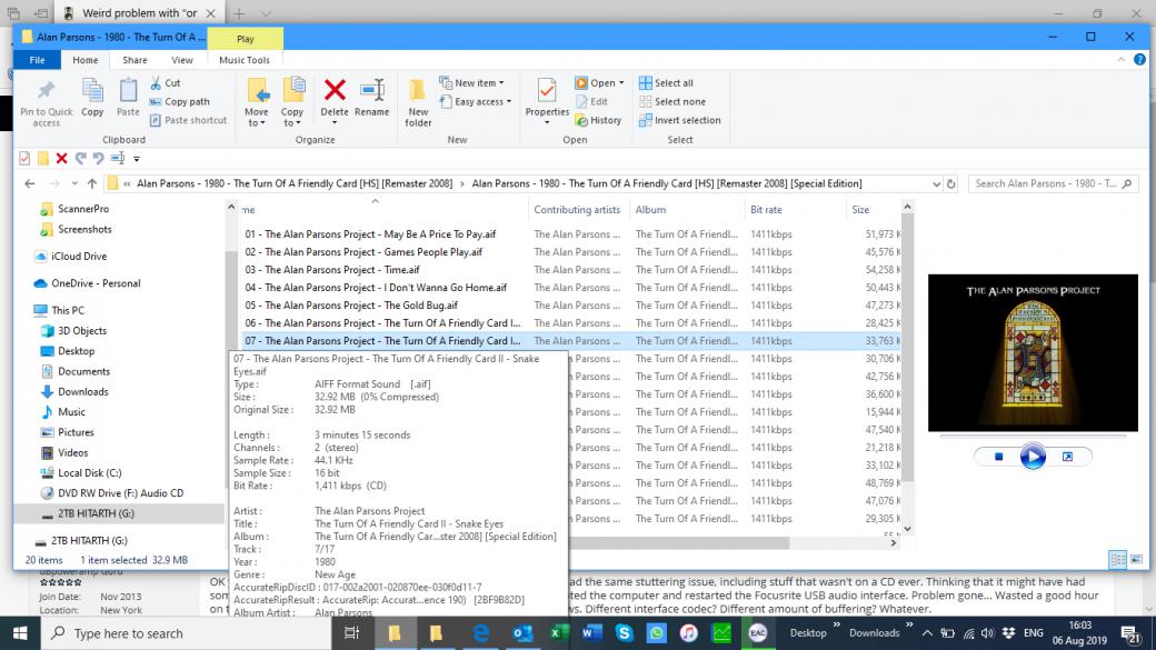

    hi,
    I have ripped a CD and received a report all tracks ripped accurately (attached report. I tried to copy the tracks to iTunes ( dragging the folder to iTunes ) I have only some tracks copied. on checking the files, I have some files with errors & some are ok. pls find attached screen shots
    Log.txt
ID:	297397Click image for larger version
ID:	297398Click image for larger version
    pls notice the remark on the preview pane on the right

      Re: Weird problem - some tracks do not copy to iTunes
      Did you check the length of the path of those missing files? The path looks quiet long.
        yes, you were right !! thanks
        I copied the folder to the desktop & re copied the files … many thanks
