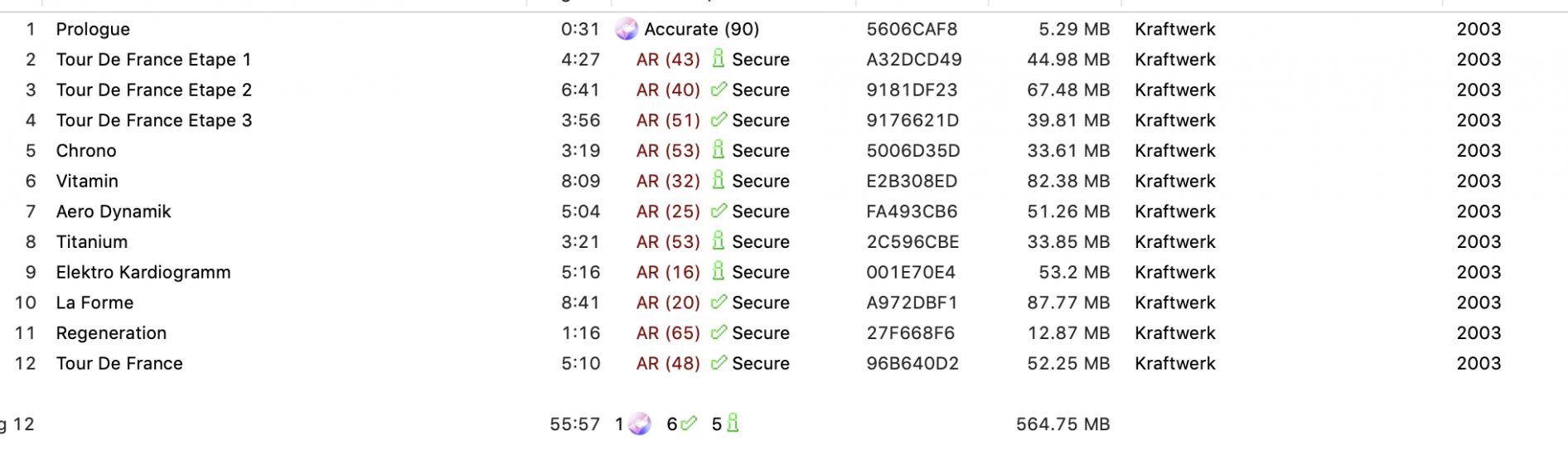

    Hi all.
    So below is my result when ripping the Kraftwerk Tour De France Soundtracks album.
    It has copy protection on the disc & I'm wondering whether the green ticks & green "I"s should be taken at face value, as in the help notes, or whether these are a by-product of the copy protection.
    Is there anything I can do about getting a better rip?
    Thanks!

    Your results suggest you likely did get a good rip. Secure or secure with "i" showing it had to reread some frames. I suspect if you play these files, they will not have any problems.
      Re: Help with copy protected CD rip results
      I'm with garym here. For a copy-protected CD, I'd say you have a pretty good result.
        Ah, well that's good to know.
        It's just that I was confused by the help notes that has a Red X, AR(12), a green "i" & then: "Your ripping result disagrees with 12 other peoples rips, the green i indicates that frames had to be re-ripped, possibly an undetected error has slipped through. If all tracks except one have an AccurateRip verification, and the confidence (number shown in brackets) is more than one, it is likely your rip has errors."
        Mine is obviously lacking the red X so maybe that's what makes the difference.
        Thanks for the replies.
