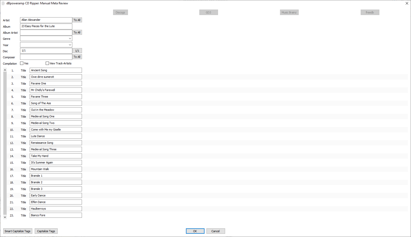

    Greetings,
    I have used dBpoweramp for some time to rip CDs, but only on an irregular basis, so do not understand all of the intricacies involved. Repeatedly, however, I run into the following issue (possibly an important detail: for CDs that come with music sheets, so aren't available in CD stores or likely to be found on provider data bases):
    When putting the CD in a drive, initially the track titles are listed as one would expect, only to be changed to simple track numbers (Track 1, Track 2, etc.) seconds later.
    Usually, in order to have the best possible data or match, I select all providers, but have noticed in cases such as described above that selecting only CD-text seems to work. CD-text combined with MusicBrainz and/or freedb and/or PerfectMeta also seems to work. CD-text in combination with Discogs, on the other hand, doesn't work.
    What could be the cause of this? Or is there something I'm doing wrong? The only thing I can think of is that there's some order of precedence amongst the providers, where one (with unknown or blank records) overrules the one that has (CD-text in this case). Selecting single providers one by one under Retrieve Metadata From is a possibility to bypass the issue, I suppose, but that can be a bit tedious if you have a few dozen CDs.
    Thanks in advance for any ideas, suggestions or solutions.
    Luc
    Btw, I'm using release 16.6
    Re: Track Titles Disappearing in CD Ripper
    You see the track details filled in (from CD Text) then is removed by no match from Discogs?
    • Luc
      • Nov 2017
      That's correct, Spoon. Only with Discogs this appears to be the case.
      For what it's worth, I have tried with all four providers separately (Discogs, GD3, MusicBrainz and freedb) and none of them have data/track titles for this particular CD I'm using to test (though the problem occurs with several others, all from the same publisher). However, only when combing CD-Text, that does have the data, with Discogs the track titles are cleared and renamed Track 1, etc.
      Strangely enough, when combining CD-Text with PerfectMeta (which, if I'm correct, searches all four providers, i.e., including Discogs) this clearing of track titles does not occur. So for now, I have selected CD-Text and PerfectMeta as Active Providers, although it looks like there is either a bug or an unintended "order of precedence" of Discogs over all or some others.
      I hope this information helps, and thank you for your assistance.
