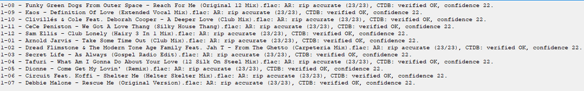

          The album used in this example is a 2-disc set. Disc 1 ripped 100% correct according to (and with) dBpoweramp. CueTools agrees:

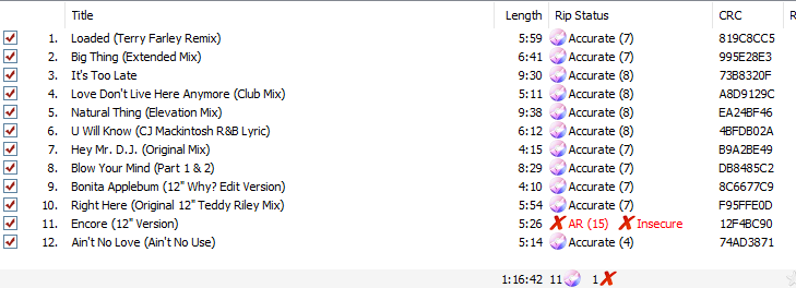

          Then disc 2. Disc 2 has 1 track that isn't ripped correctly according to dBpoweramp:

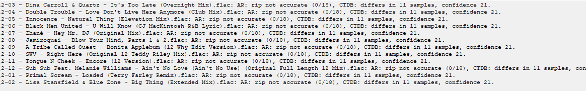

          But when loading the files into CueTools, suddenly all tracks are inaccurate:

              dBpoweramp verified the Rip, there is nothing more to do. Cue tools gives a clue also, each track only differs by 11 samples, for each track. This means you have a different pressing to the one in CueTools dB. Cutetools is not able to lookup independent of pressing offsets, like dBpoweramp can with AccurateRip v2, that is why dBpoweramp matches and Cuetools does not.
                I still find it quite weird that for any disc with a single wrong track the whole disc is suddenly inaccurate (according to CueTools), but any disc with accurate tracks can be perfectly matched by Cuetools. I don't think it's a pressing difference, but more likely a bug in CueTools. Nevertheless, as user mville posted above PerfectTunes can do exactly what I was looking for so I'll ditch CueTools again
