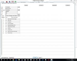

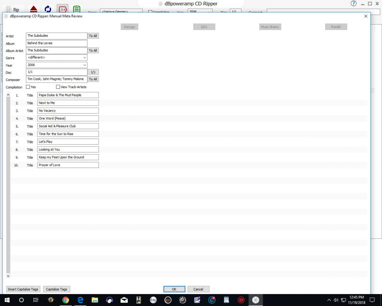

                    Re: Metadata providers grayed out
                    Hello,
                    I've clarified my comments on the attached screen dump .jpg I've uploaded the .jpg through the <Insert Image> click box.
                    I've included the page in cd ripper that shows:
                    1 .
                    ..when I am on the screen (...CD Ripper: Manual Meta Review) the metadata providers are still blanked out/unusable.
                    2.
                    Since the Meta providers link does not work on this page, the blank space limits copy & paste of metadata from other websites..
                    Happy Thanksgiving!
                      • 46160
                      Your post contains no image, please add again.
                      • telstar
                        • Oct 2018
                        • 12
                        I think I uploaded the file.....it shows under Manage Attachments.
                          • 46160
                          Yes this is taken from the cache, click OK (on that screen) then the refresh button (blue 2 arrow button on tool bar) it re-reads the metadata from the internet.
