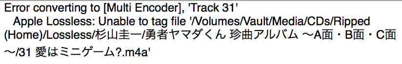

    I've found that when ripping CDs with Japanese track names, if the track name contains a ? (question mark) character, the output file will encode with an error. (It seems to be when trying to add tags/artwork.)

    1. Rip a track titled: Click image for larger version
    Result: the following error: Click image for larger version

    3. Rename the track back to Japanese but remove the question mark from the end
    Result: encodes properly!

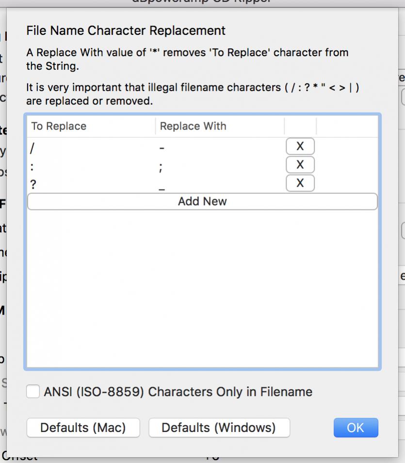

    I thought I could fix this with Preferences > File Name Restricted Characters, where there actually is an entry for "?", but oddly, in no circumstance is the "?" replaced with "_" in my filenames. Separate issue/failure on my part? See screenshot: Click image for larger version
Name:	Screenshot 2018-08-25 22.09.02.jpg

    As for substitution rules being disregarded -
    There are two places in dBpoweramp application where these things are configured - regular Converter settings and CD Ripper settings.
    Currently, the multi encoder does not know which one it should be obeying, so it obeys the former. It can indeed be annoying. It will be addressed in a future update.
