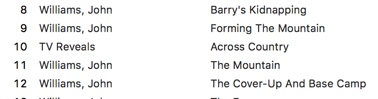

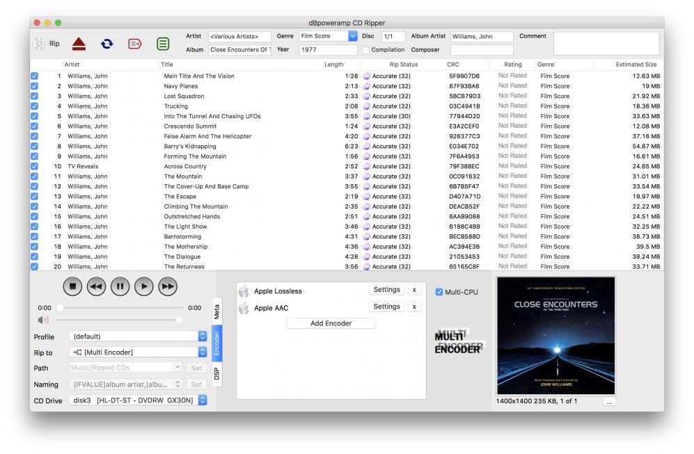

    I've noticed that any track name that has a slash in it causes weird things to happen.
    For example, I'm looking at Close Encounters by John Williams.
    The "Artist" for every track is John Williams.
    However, on a track called "TV Reveals / Across Country", the "Artist" is set to "TV Reveals", and the Title is set to "Across Country".
    See this screenshot:
Name:	Screenshot 2018-08-18 18.04.30.png
    Any idea what's up?
    Thanks!

      Re: Track names with slashes are parsed incorrectly?
      Screenshot is from dBpoweramp Music Converter, Release 16.3 (1), macOS 10.13.
      And I can reproduce this consistently with any track name that contains slashes.
          Sorry, I am not familiar with such a view in dBpoweramp Music Converter.
          Heh! I truncated my screenshot so it was just the relevant bit. I thought I was being helpful!
          Here's the entire window: Click image for larger version
Name:	Screenshot 2018-08-18 19.22.22.jpg
          You can see the "TV Reveals" mix up on Track 10.
          Thanks for looking into this!
          -Cabel

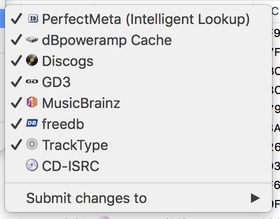

              Are you reviewing the metadata from the 4 online data providers? If so, which provider do you select.
              I have all the providers checked: Click image for larger version
Name:	Screenshot 2018-08-18 21.10.19.png
              However, when I "Clear Track Metadata" then "Retrieve Metadata From" each provider, the one that returns the results is freedb

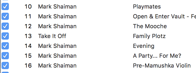

                      I know because every time this happens — and it happens on ANY and ALL discs that have a "slash" in the "Title" — when I search the FreeDB online database for the album, the data is listed correctly.
                      Let me give another example, I'm ripping "The Addams Family (Extended)".
                      dBpoweramp does the bug, splitting at the slash on Track *13: Click image for larger version
Name:	Screenshot 2018-08-19 10.05.48.png

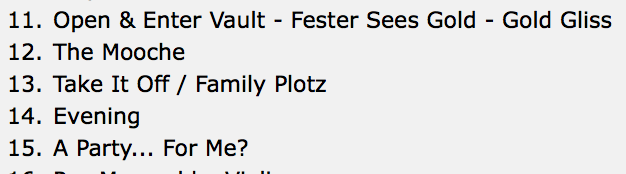

                      But the FreeDB online interface shows this track correctly: Click image for larger version
Name:	Screenshot 2018-08-19 10.06.26.png
                      You can verify this yourself by hitting the following URL showing their database entry: http://www.freedb.org/freedb/soundtrack/cd108c1e
                      In short, this is not a FreeDB problem.
                          Here is the freedb specification:
                          TTITLEN:There must be one of these for each track in the CD. The track
                          number should be substituted for the "N", starting with 0. This field
                          should contain the title of the Nth track on the CD. If the disc is a
                          sampler and there are different artists for the track titles, the
                          track artist and the track title (in that order) should be separated
                          by a "/" with a single space on either side to separate it from the text.
                          In your example there is TTITLE12=Take It Off / Family Plotz which indicates by the standard that the Artist is 'Take It Off' and the Title is 'Family Plotz'

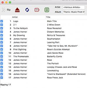

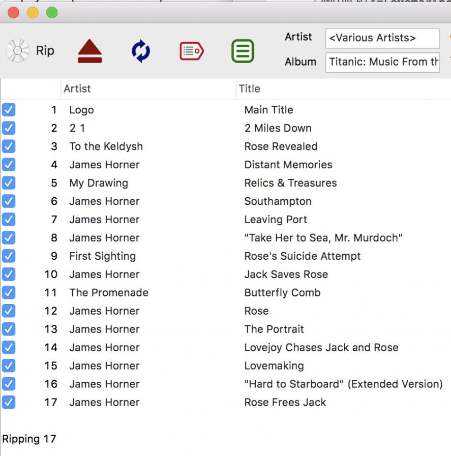

                            Ok, I dug around even more.
                            And yes, you're right! But geez what a horrible design for a database!
                            I got a little nerd-core and I busted out my ethernet packet sniffer to look at the exact query dBpoweramp is performing against freedb.
                            1. I am testing the disc "Titanic (20th Anniversary Edition)"
                            2. I clear the metadata cache
                            3. And I do "Retrieve Metadata From" > "freedb".
                            Here is the URL that dBpoweramp is going to get the track data!
                            Here's the freedb data that's being sent to dBpoweramp:
                            Code:
                            DISCID=fc0db311
                            DTITLE=James Horner / Titanic: Music From the Motion Picture - 20th Anniversar
                            DTITLE=y Edition (CD1)
                            DYEAR=2017
                            DGENRE=Soundtrack
                            TTITLE0=Logo / Main Title
                            TTITLE1=2 1/2 Miles Down
                            TTITLE2=To the Keldysh / Rose Revealed
                            TTITLE3=Distant Memories
                            TTITLE4=My Drawing / Relics & Treasures
                            TTITLE5=Southampton
                            TTITLE6=Leaving Port
                            TTITLE7="Take Her to Sea, Mr. Murdoch"
                            TTITLE8=First Sighting / Rose's Suicide Attempt
                            TTITLE9=Jack Saves Rose
                            TTITLE10=The Promenade / Butterfly Comb
                            TTITLE11=Rose
                            TTITLE12=The Portrait
                            TTITLE13=Lovejoy Chases Jack and Rose
                            TTITLE14=Lovemaking
                            TTITLE15="Hard to Starboard" (Extended Version)
                            TTITLE16=Rose Frees Jack
                            Now, this all looked fine to me so I was sure this was a bug!!
                            But then, extra curious, I looked up the freedb database spec and, lo and behold, like you said:
                            TTITLEN: If the disc is a sampler and there are different artists for the track titles, the track artist and the track title (in that order) should be separated by a "/" with a single space on either side to separate it from the text.
                            So, I suppose dBpoweramp is doing the right thing — it sees a slash, so it assumes it's an artist and title, to be separated.
                            So what the heck are you supposed to do for a CD that actually has a slash in a track title?!? Talk about a shortsighted spec!
                            Thanks again for your help.
