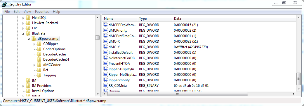

      Thank you Spoon, I reinstalled my registered version and installed 16.5 beta over it. The same behavior is seen with the failed queries for the HKCU\SW\Illustrate\PreventAutoRun registry key. As expected, the key is not in the registry:
      Is this a simple problem of needing to add this back in? I'm not sure why it would not have been recreated with one of the two installs unless the installer is checking for the presence of keys related to the software left over during an uninstall.

        It looks like the registry entries might have been a red herring. I uninstalled dbPowerAmp, removed everything left over in HKCU\SW\Illustrate and reinstalled. The polling for the missing registry key starts even before I start ripping, and thus is unlikely to be the culprit.
        In any case, R14.4 exhibited the same problem where the ripping does not progress. The elapsed time progresses, but the Ripping progress bar stays at 0% on the first track. I rebooted and installed R16.5 beta over it and observed the same results.
        Thanks - Marie
          Re: Ripping stopped working on Windows 7
          It is not this registry entry.
