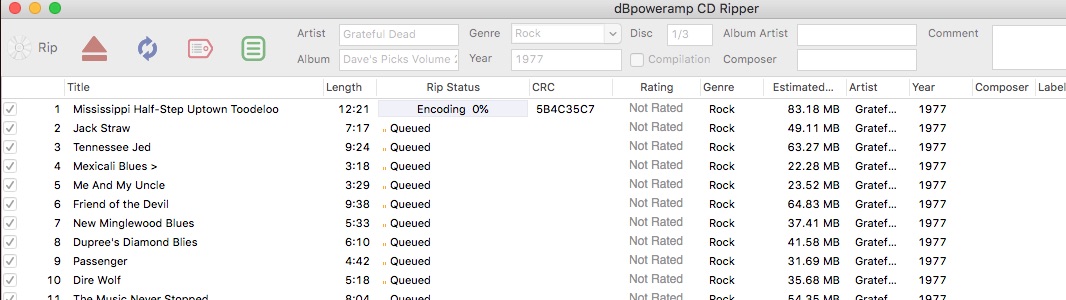

    I am trying to rip an HDCD on my mac (grateful dead 30 years around the sun). I have tried a few combinations, including ALAC + HDCD DSP, with and without the 6db thing checked, and the same permutations but with flac.
    It rips the first track, then gets stuck at 0% encoding and will not proceed, and no other tracks even try to rip.
    When it is in this state the cpu for dbpoweramp Music Converter hovers at around 100% cpu (I am on a four-core i7 w/16 gb ram, so only using one CPU). I have also tried reading/writing several different volumes.
    I have ripped to both ALAC and FLAC with no DSP and it works. Thinking that maybe this wasn't really HDCD I went back to one that I did several months ago, Dave's Pics 25, which ripped and encoded properly at the time. That won't rip the HDCD now either (again gets stuck on the encoding part).

        Moving the ~/Library/dbPoweramp out of the way fixed it. Looking through what you were asking for I found the problem: When I converted my scratch disk from a spinny-disk stripe to an SSD stripe I renamed it, but it was still set as the temporary disk (/volumes/LBD) which didn't exist, and /Volumes only has root write:
        $ >ls -ld /Volumes
        drwxr-xr-x@ 11 root wheel 374 Jun 25 07:26 /Volumes/
        So, it was definitely a config error on my part, but there was probably an error thrown somewhere that you can bubble up. Thanks for helping me fix it!
