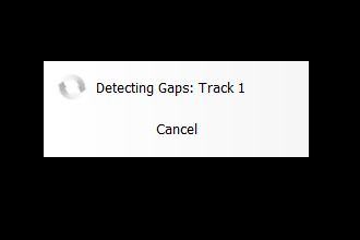

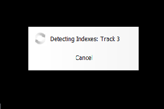

          • Max Dread
            • Dec 2013
            • 297
            Re: "Detecting Gaps / Indexes" - what exactly is it? And can the box be moved?
            OK, so here are the screenshots. I'd be mighty surprised if they were not to do with DBPA
            Perhaps someone else can say whether they have/haven't seen this before? And maybe Spoon can shed some light on the matter?
            Cheers
Name:	DBPA - Detecting Indexes.png
Name:	DBPA - Detecting Gaps.png
              When you detect the gaps, they can be displayed, or removed with certain DSP effects.
                Thanks Spoon.
                Any thoughts on the first part my original post RE hiding/moving the notification or choosing which screen it comes up on?
                And I'm also interested ot know why others do not have this pop up when I do? I presumed it was a standard feature for R16.4, but obviously not if others aren't seeing it...
                  It is only shown if you have a column set to show gaps, if you go for the default columns then it will not need to detect the gaps.
                  We will look into why it comes up on the wrong screen.
